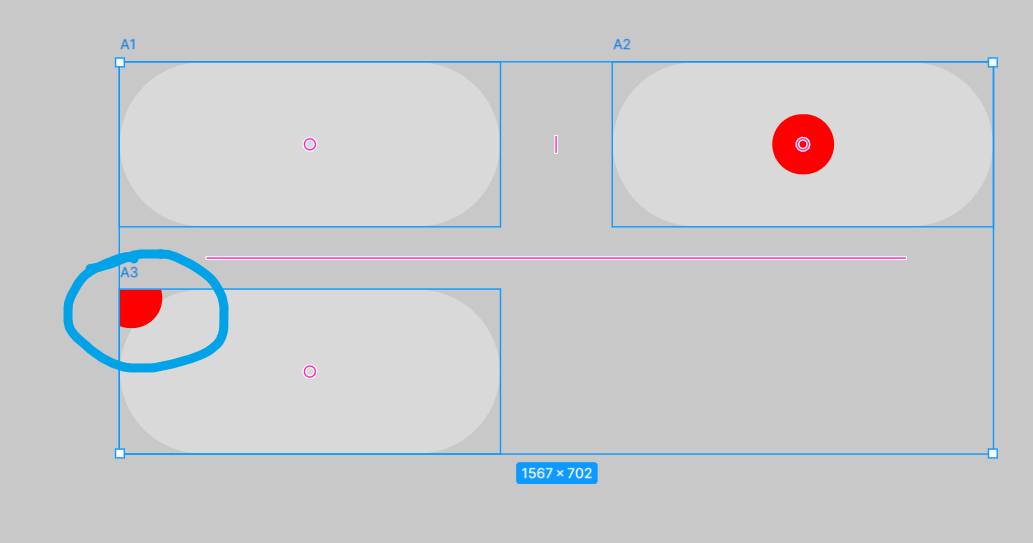

Hello, I would like to ask, after I enable the Clip content function on an ellipse, why does the Clip function not cut according to an ellipse as a border, but a square? I don’t know if my statement is correct…=(

Hey there, not 100% sure without looking at your layers panel but I think you need to add the rounded corners to the parent frame instead of the child shape. So A1 should have the desired fill and corner radius. Hope this helps
