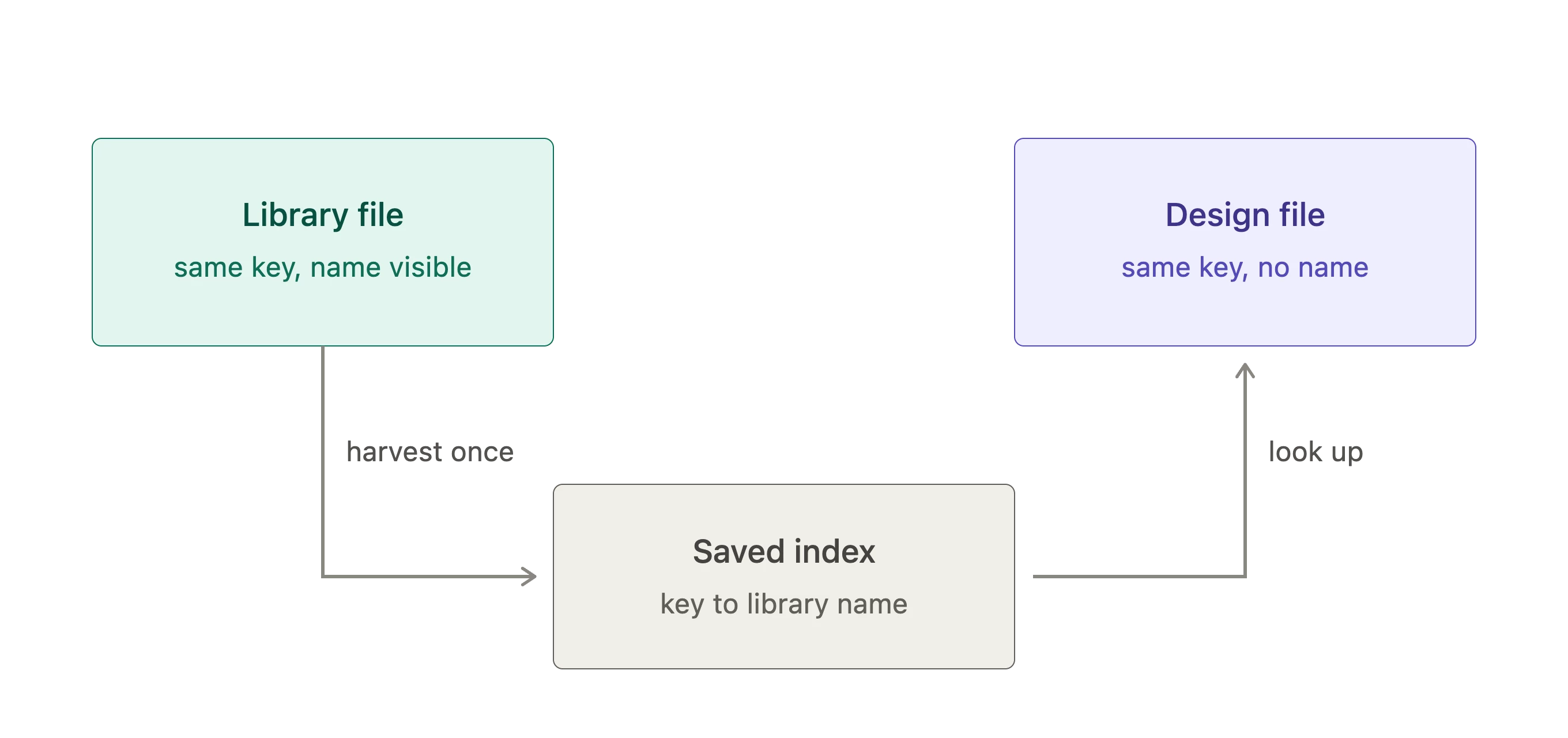

And for the curious, here’s how the local workaround is happening:
The trick is that a component's key is the same string everywhere.
A key like 1059543914f0162... is global and permanent. When standing inside the library file, that component is local — so you can read its key, and you can also read the file's own name. When in a design file, the same component shows up as remote — you can still read the key, but the name is gone.
The key is a join column:
  • Run the plugin inside the library once
  • Write every key → this file's name pair
  • From then on any design file can look a remote key up in that list and get the name back
Have fun building! — Jaycee
