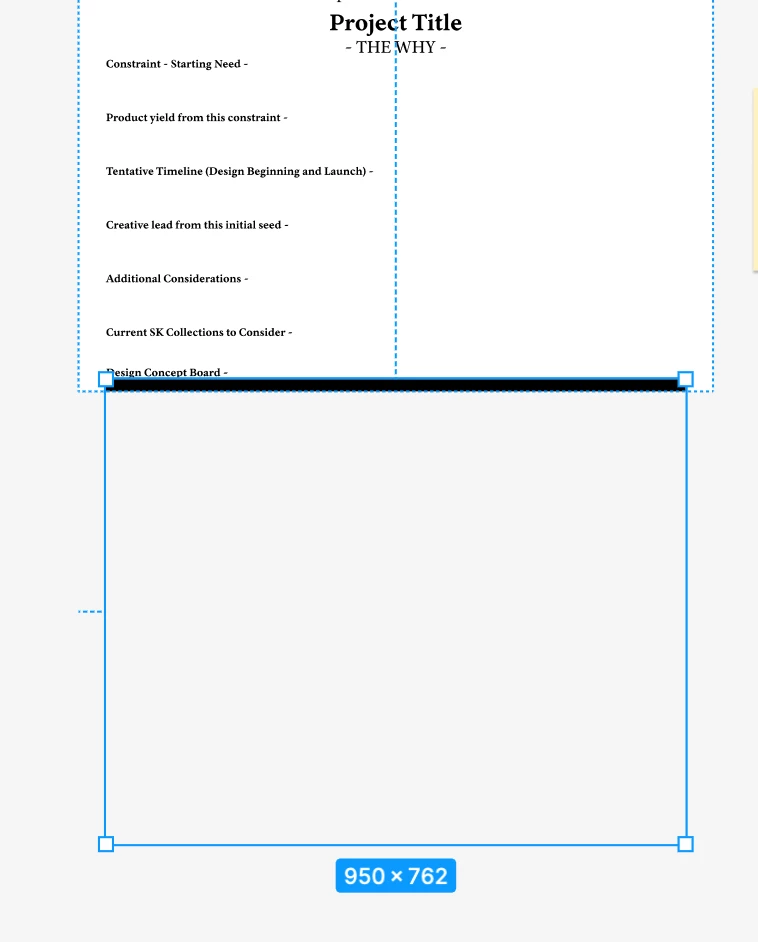

One other thing since I have you… I am really struggling with autolayout.
I create a card with a text blurb and an image frame below. I want the card to grow in height and stay the same in width when there is a lot of text added. I also want that when I grab the bottom edge of the frame and lengthen down, the image frame joins.
I get everything laid out, then I use autolayout and that solves the first problem with the text, but then I drag down the frame and what was working before with constraints settings I had (top and bottom) are no longer working. When I go to adjust them this is what happens.
I am confused. Maybe you are confused? Maybe you understand? I am unsure.

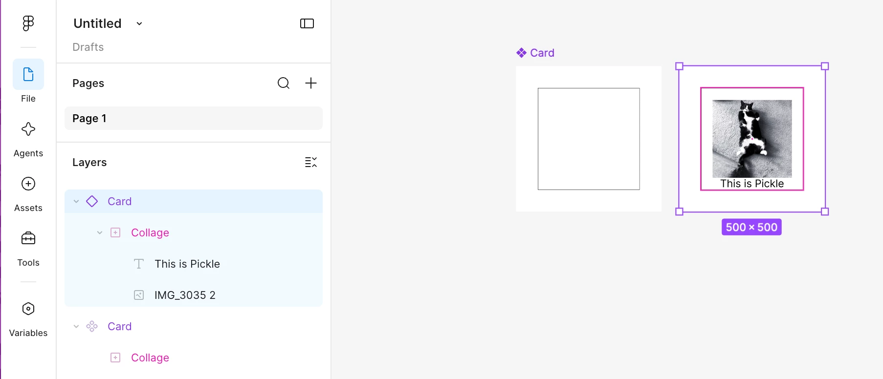

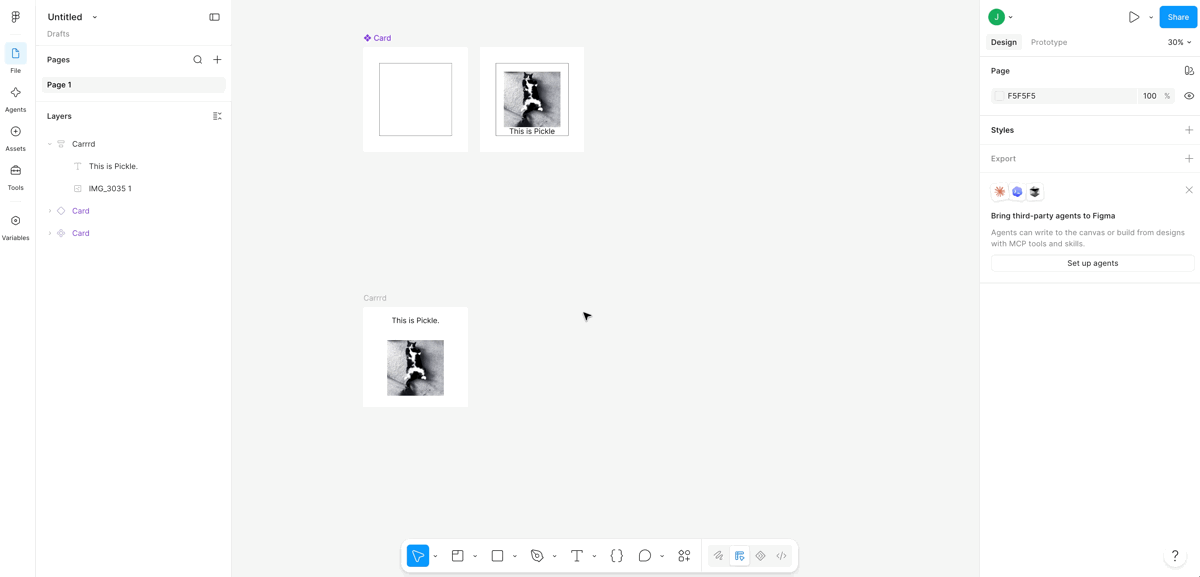

Hey hey ​@Caroline Campbell 👋
Images in slots: Yes — slots aren't limited to instances. You can add any layer type inside a slot, including raw images and text. So a card with a slot as its "collage" area lets you freely drop in images and text blurbs and rearrange them, no detaching needed. That's your Google Slides workspace, basically.
Two things to know: inside an instance you can move/add/delete slot content freely, but the slot's position, auto layout direction, and constraints are edited from the main component, not the instance. And component properties can't be applied to layers inside a slot (doesn't affect a plain image+text collage). Doc: https://help.figma.com/hc/en-us/articles/38231200344599-Use-slots-to-build-flexible-components-in-Figma
Slots vs. auto layout: not either/or — they pair. Slot = flexible content container; auto layout = how that content stacks and spaces. Card = auto layout, with a text area + image slot inside.
