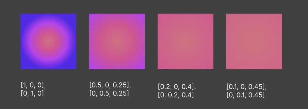

Has anyone successfully worked with affine transformations (gradientTransform)? I had no luck understanding how it works.
I need to do really simple thing
  • scale gradient 0.5x, 1x, 2x within node
  • change position x, y within node
from this video it seems quite easy to do, but for Figma API it does not work same way (or i am missing something).
How do i calculate transformation matrix to get desired B result?

From my understanding if i want to scale it 2x, it should be like this. But instead of resizing, it does opposite β†’ downscales gradient. 😬 & also it’s not centred anymore
image (12)
After manually coming up with matrix values i did get desired result, but i cannot figure out the logic behind it.
Michael_Yagudaev
The gradientTransform matrix is multiplied by another matrix to normalize the coordinate space to be [0…1, 0…1].
A simple way to do this is to multiply by the inverse of the gradientTransform. This has the side-effect of inversing the scale factor.
However, it makes it easy to place the gradient handles and convert them back and forth from that to a transform for editing purposes.
I’ve created a gist here: Figma convert `gradientHandlePositions` to `transformGradient` and vice-versa Β· GitHub with my code for converting between gradientHandlePositions provided by the REST API and gradientTransform provided by the Plugin API.
I hope to do a deeper write-up on it this weekend. I was stuck on this for days as well. But it is incredible how elegant the solution is once you understand it 😁.
