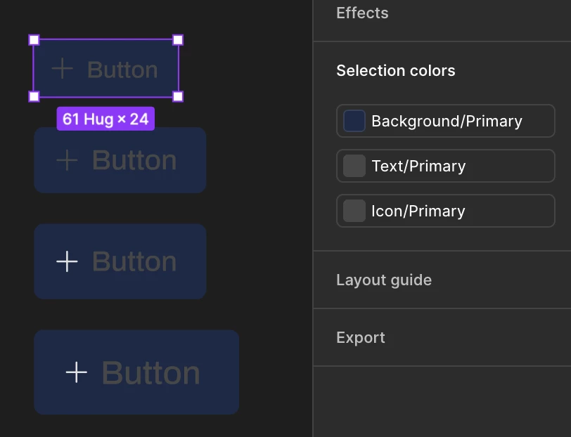

I am still having this issue. When I change the button mode for the size, in two of the modes, the icon color is not coming as per the variable set for the icon. It is breaking to the original Icon component color.
For example this is the disabled state of 4 sizes(set up using modes) of the button. In two of the sizes, the icon color is correct, but in the other two it is getting overrides with the original icon component color.
Any workaround for this?
