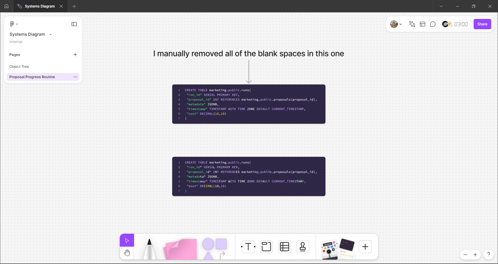

Hi guys,
I am a new user to Figma, specifically FigJam. I am using it to plan some projects and have noticed issues with the syntax highlighting for the code block in FigJam.
The issue can be repeated by copying and pasting code which results in blank spaces being placed after the line delimiter.
After checking on the forum it seems that this is a very old problem. I am curious as to why it hasn’t been resolved yet. It is quite annoying in our use case, as we are doing micro-service architecture.
Is there any solution aside from having to manually delete the white spaces? I have noticed when keeping the code in a separate application, in our case Notion, using the copy function on Notion and pasting into FigJam it *sometimes* works and doesn’t include the blank spaces.
Not a critical issue but very annoying.

Hi ​@Temuujin, Thank you for bringing this to our attention!
I understand how inconvenient incorrect syntax highlighting can be. We appreciate you taking the time to share the screenshot and look for similar reports on our forum.
I've been able to reproduce the same behavior on my end, and I'll submitted a report to our product team for tracking and review.
While we can't promise a specific timeline for a fix, we really appreciate your help in making this issue more visible.
Thank you again for your valuable input!
