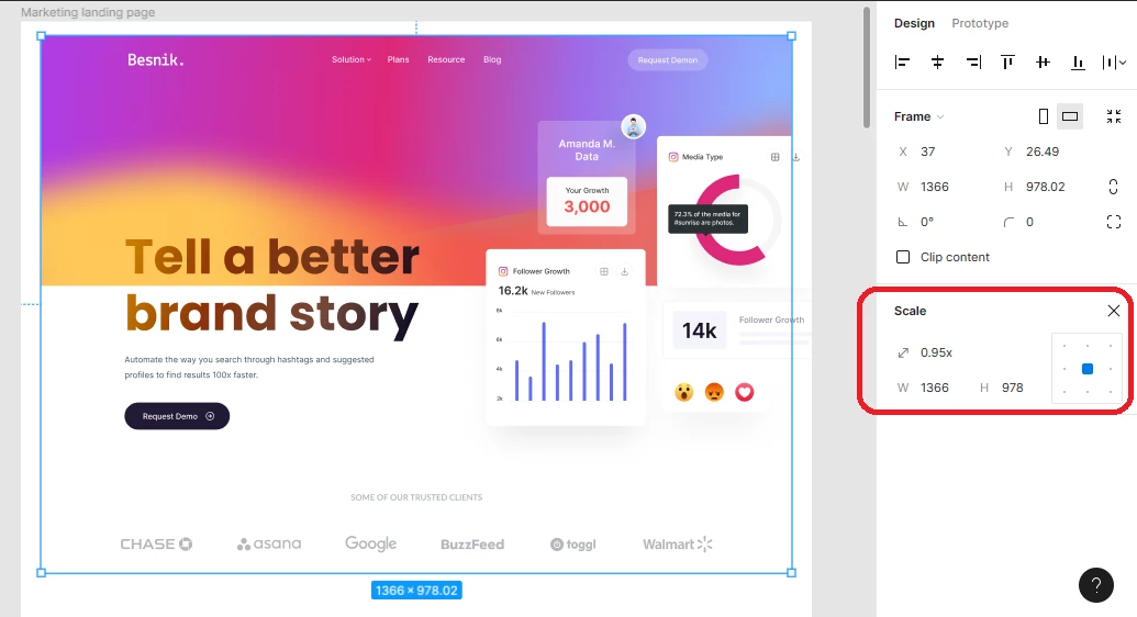

Hello Hunter ,
Open your design in Figma , then select the frame then press letter k to use the scale built-in tool in Figma and set the width to required value ( 1366 in my case).
Please attached photo
