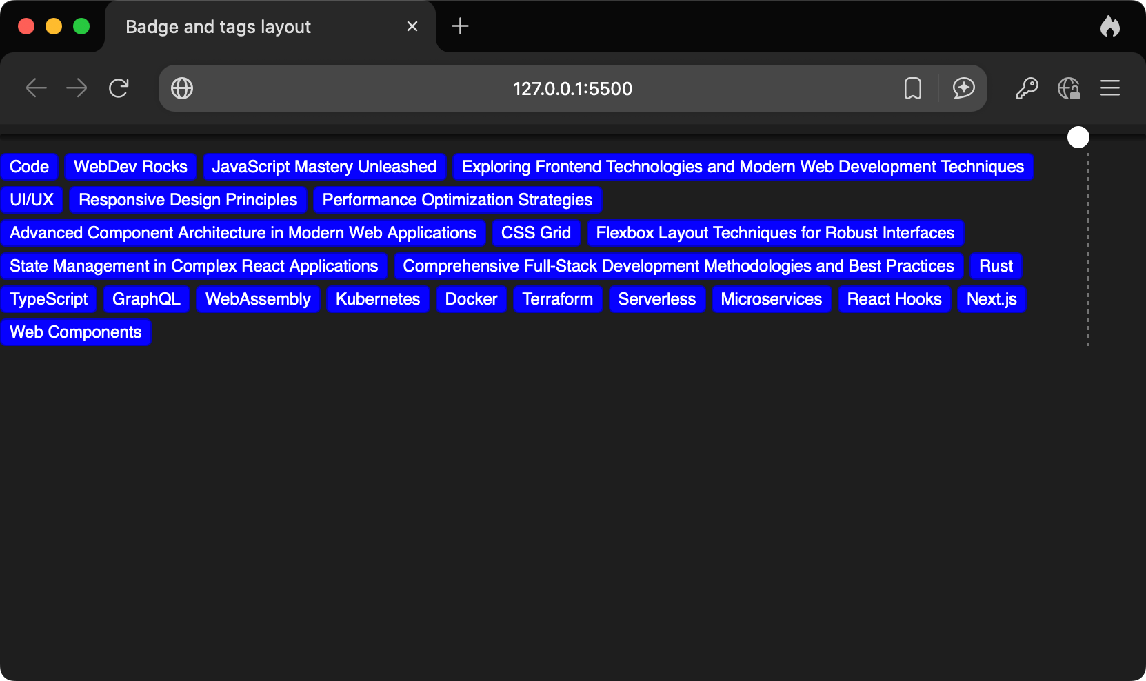

So, bringing this discussion to a real case: I made a component for my DS called “chip” with some variants as we can see on this print:

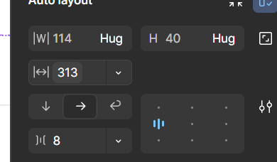

 The width’s component need to follow their inner content to keep growing on the sides as we can see:

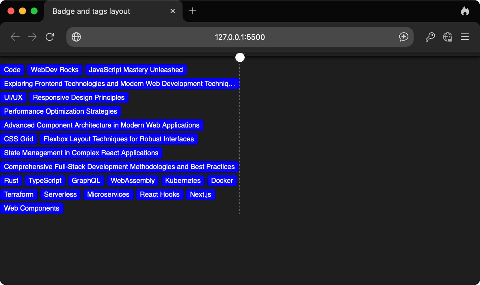

but this growing effect (which is possible glad the ‘hug’) need to stop when reach the max width from the chip’s parent container and this, Figma can’t help me. So, the chip should grow to accommodate the text in width, up to a maximum determined by its parent, and then it should start growing downwards in height.

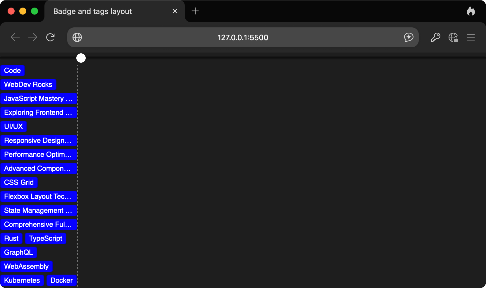

 I’ve tried a lot of things to simulate this behavior, creating equations and math to calculate the max-width based on the div/container where this chip are but none of the solutions really solves this issue. And I have problems like this:
Am I the only one suffering from this? Has anyone figured out how to get around this?

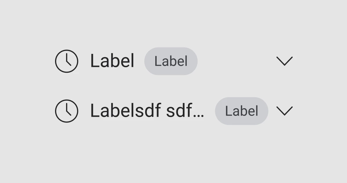

I have multiple components where I have a label with ellipsis overflow. When choosing for a ‘fill’ width, the ellipsis works perfect. But when I have an object (like a badge or tag) which is aligned with the label content, I have to set the label to ‘hug content’, but I cannot set a max-width 100% on the container. Very unfortunate.
For example:

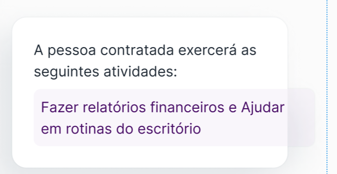

I felt like I was dumb for so long because I could not for the life of me figure out how to get an inline tooltip to hug the last word of a block of text, and wrap WITH the tooltip when it overflowed the width of the parent frame. Am I correct in assuming that functionality for the above would also theoretically allow for this behaviour?
