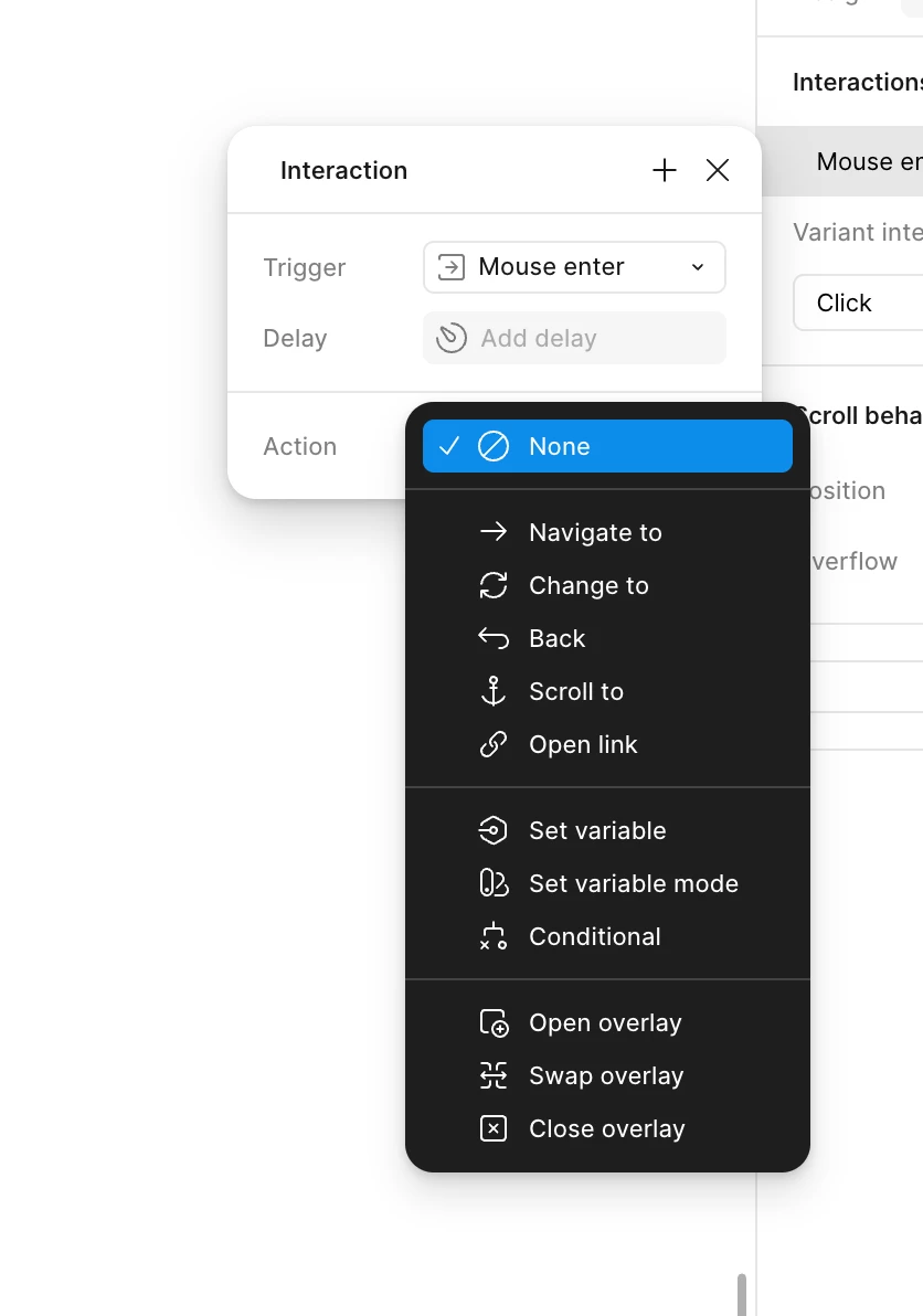

Hatim Dossaji
We need a “on mouse enter” disable interactions below. So on any dropdown, layers below would not interact all the while the drop down itself has all the required interactions (hover, click, etc)
Xavier_Godbout
In my opinion, it should simply respect your layers orders.
