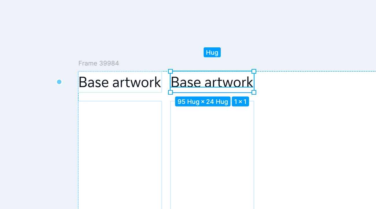

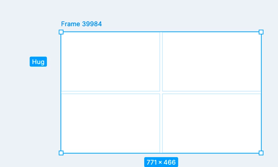

Seems like there a way to create rows and columns that hug content. Here is how you can do it
  1. Create a frame
  2. Hit Shift+A, make it auto layout frame, make sure that sizing is set to HUG both directions
  3. Convert it to grid
  4. Now you have 2x2 grid with auto sized rows and cols
There is no direct way to enable this sizing option within the UI, however if you add a layer inside and then you duplicate it it would add another column with “Hug” sizing enabled
Not quite clear how to add more rows though...
  1. Create a frame
Clever trick! Sadly, additional rows/cols initialize as “Auto”. I guess it’s a sign that it’s possible, but maybe it’s just not fully implemented yet.

Duplicating frames inside the grid would create extra columns and rows with “Hug” sizing inherited. This is the only way I found yet.
