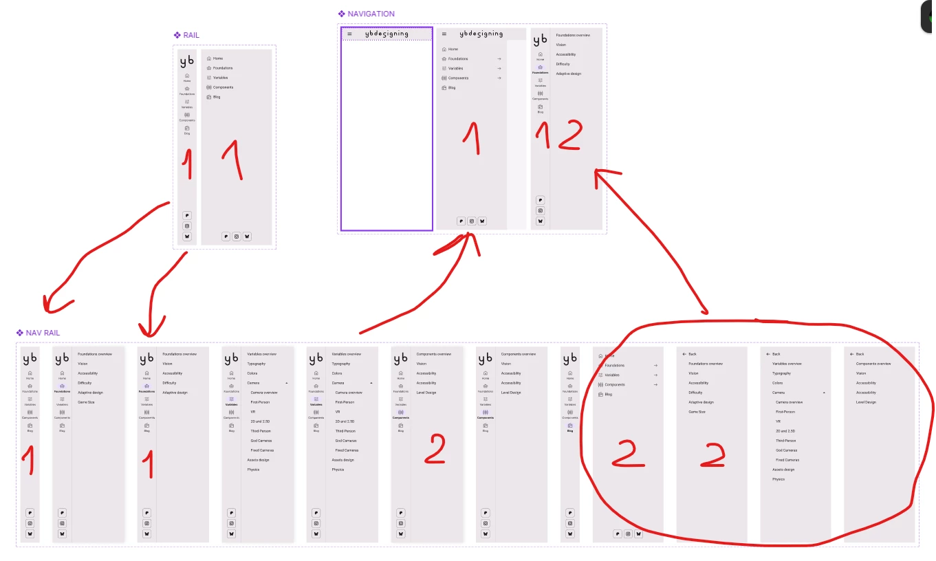

Hi, I’ve solved this problem by creating fullscreen fixed Navigation component that has 2 mobile states for header (closed, open) and desktop rail.
The main rail has two states - mobile and desktop
It is used inside drawer with the submenu (forgot to rename it in screenshot)
And the drawer is used inside full screen navigation component.

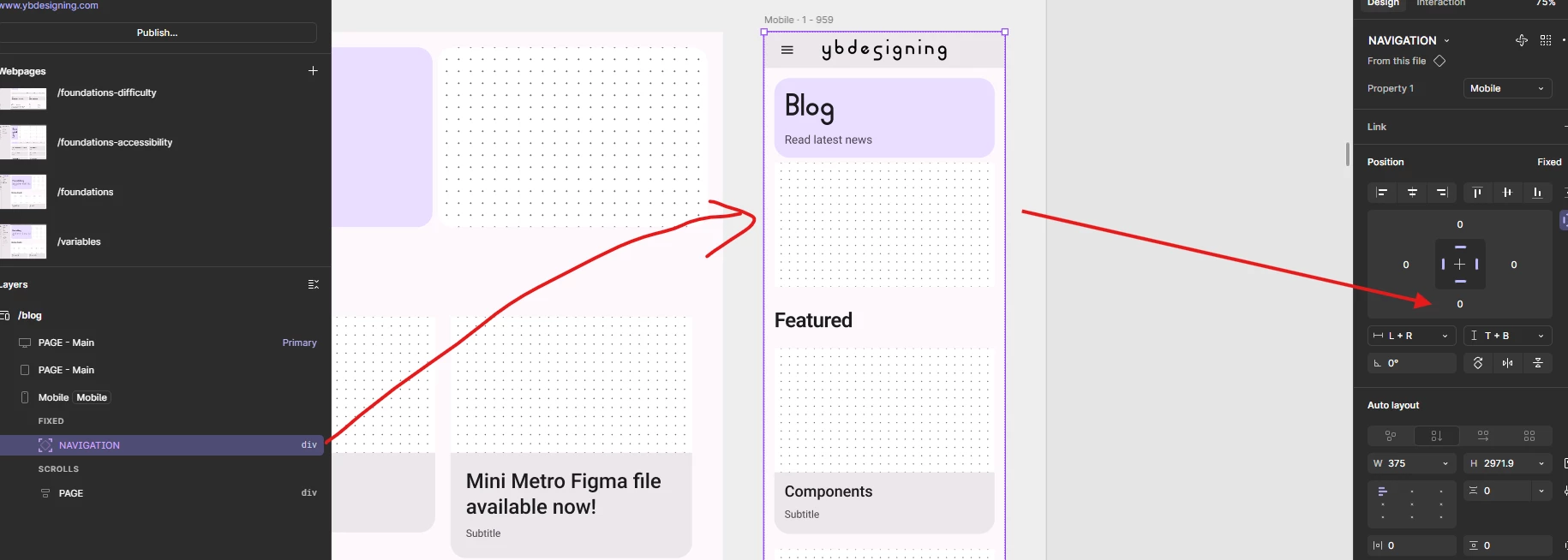

Then I place it in mobile version as fixed and resize it to fullscreen with restrains from all sides. So, for that reason it understands where screen height ends.
When navigation opens from header, it works as you would expect.
And desktop version does too.
My method only has one problem / bug:
You can’t click anything in mobile version, as transparent navigation frame prevents it. But I am pretty sure that it should not do that. Will create a topic on that.
