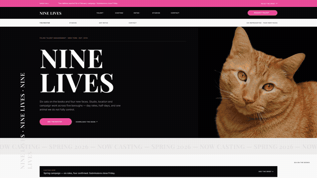

aaronjellis
Nov 21, 2023 9:15 PM UTC
I agree with @Phill_Cresswell, that having a Z-Indez override would be ideal here.
I’m building everything with auto layout, and that means to get it on top, it’s actually a lower layer level, meaning when it sticks at the top the rest of the content scrolls over top.
I also very much agree with the swap on scroll idea too. Often a drop shadow appears only on scroll for a header, and there’s no clean way to implement this in Figma.
Here’s a demo of sticky headers in and out of auto layout.
