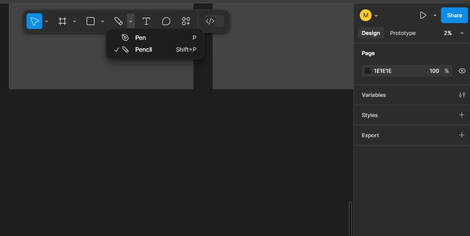

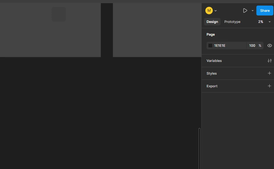

Here’s the preview when it’s shrined:
And on hover or when menu is open it stays open:
