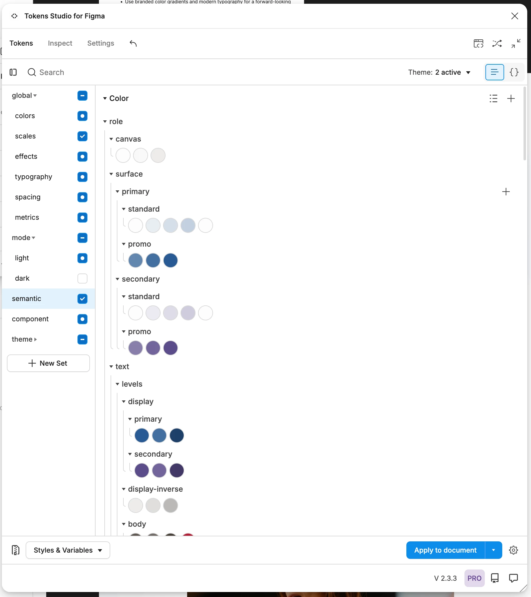

Tokens Studio properly inherits in the right order
  • Global types carry core color, size, and other technical declarations
    • Scales are a global type that determine primary/secondary/accent/contrast colors (25-950) as a baseline), sourced from the raw color scales in colors.json
  • Mode (light/dark) follows the system preference and declares globals with a caveat that all color is determined by the scales global (ex. {primary.400}) and not the raw color scales (eg. may-green.400)
  • Semantic declares things like surfaces, borders, shadows, etc that a Figma designer would use day-to-day when branding the core components. It resolves to mode but without the light/dark attached (so it follows the system in code). This is our first thematic mode. All spiffy to here.
  • Overrides is where Tokens Studio works but Figma goes sideways. Here I re-declare the scales by theme name. When a scale is selected (blue, purple, event name, whatever), and declared by a template, all of the color scales adapt without changing the scale values. This is the killer feature.
  • Components matches HeroUI slot values and resolves to semantic.json (which resolves to mode and follows color overrides). This allows designers to declare a semantic scale and see how things re-color, and then make deeper token decisions as required with an ability to understand how inheritance affects all of the theme combinations across the system.

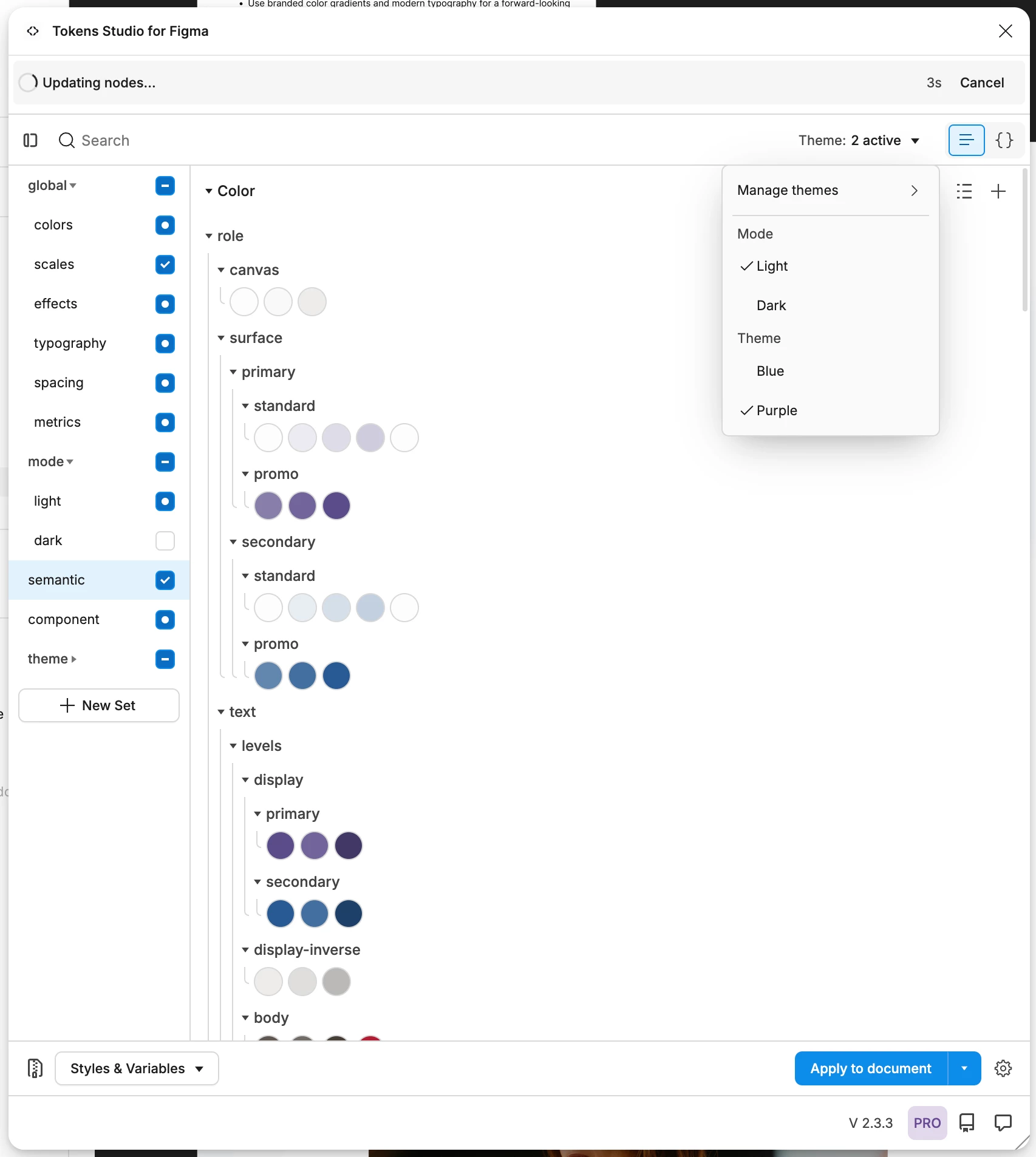

Except that it doesn’t work. Figma requires flat modes and selecting “light” and “purple” at the same time simply leaves it blue or, depending on how I flip the inheritance “light blue” or “dark purple”. Sure, I can write a Node application that manually flattens the theme and import that into JSON but the friction involved completely invalidates the point of Tokens Studio theme integration.
Of course, you wouldn’t KNOW this doesn’t work without a pro account. Want to see exactly how badly it fails? There’s a demo for that: https://www.figma.com/community/file/1245693386224897967
Convert the honest-to-god Tokens Studio multi-dimensional theme demo with complete and functional tokens into a Figma theme.
Light + Purple
Light + Blue

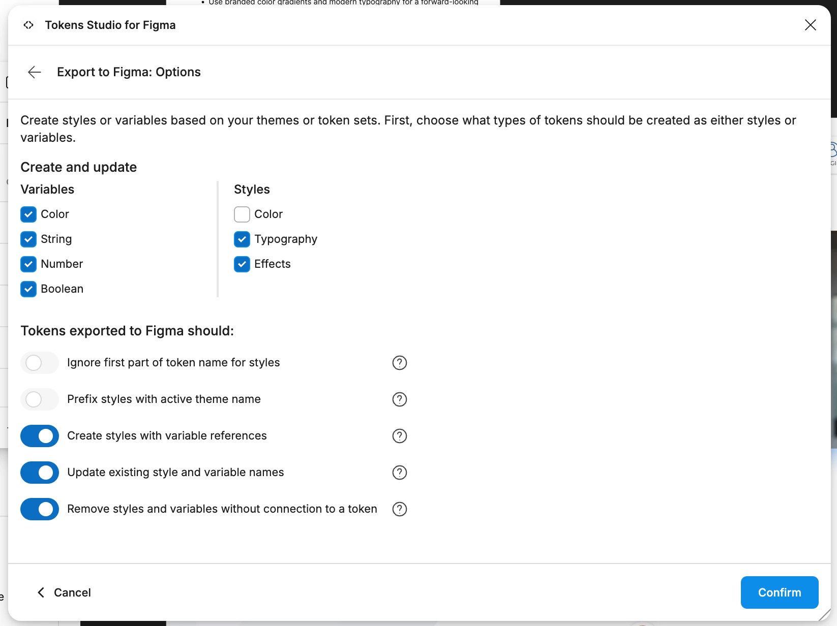

Output settings that avoid variable/color collisions in Figma (trust me on this)

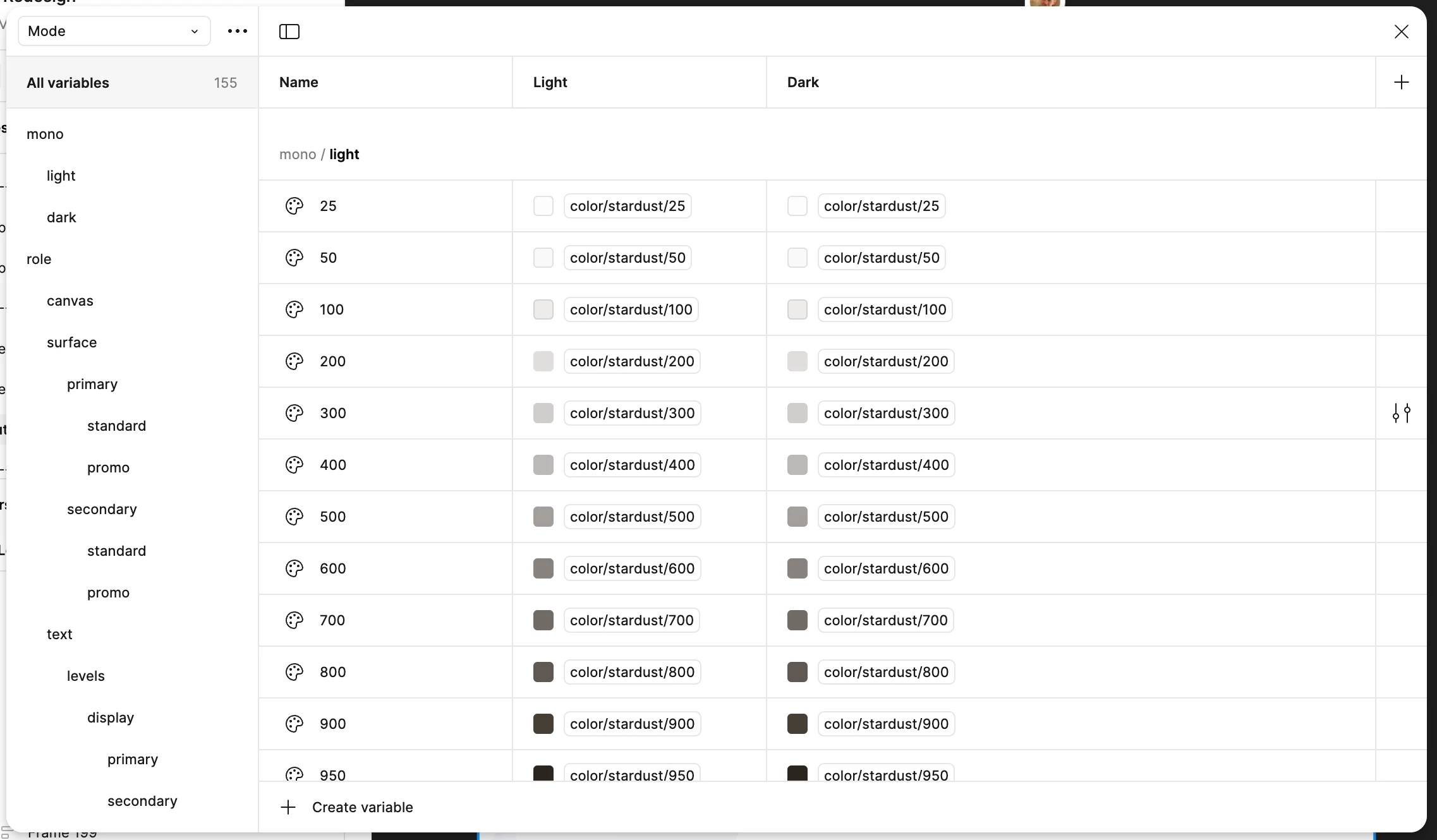

Mode (Figma does not pick up stardust (hint of gold) vs neutral (true) on the mono scale
Branded colors are an independent set of variables, not tied into mode
