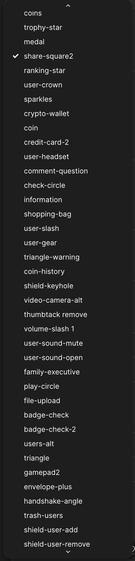

Component list search field
In our project, we are using around 300+ icons, and we fetch these icons through a component. The list of components is very long, so it is quite difficult to find the icon we want. It would be great if there was a search button here, and we could easily search for and select the icon by its name.
Wouldn't it be great if there was a search field added here?

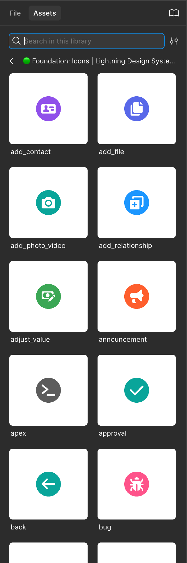

Sure thing!
Here’s an example from a component library I’m working with. Each icon in the library is its own component, allowing you to use the search field in the asset panel to find the icon you want easily.

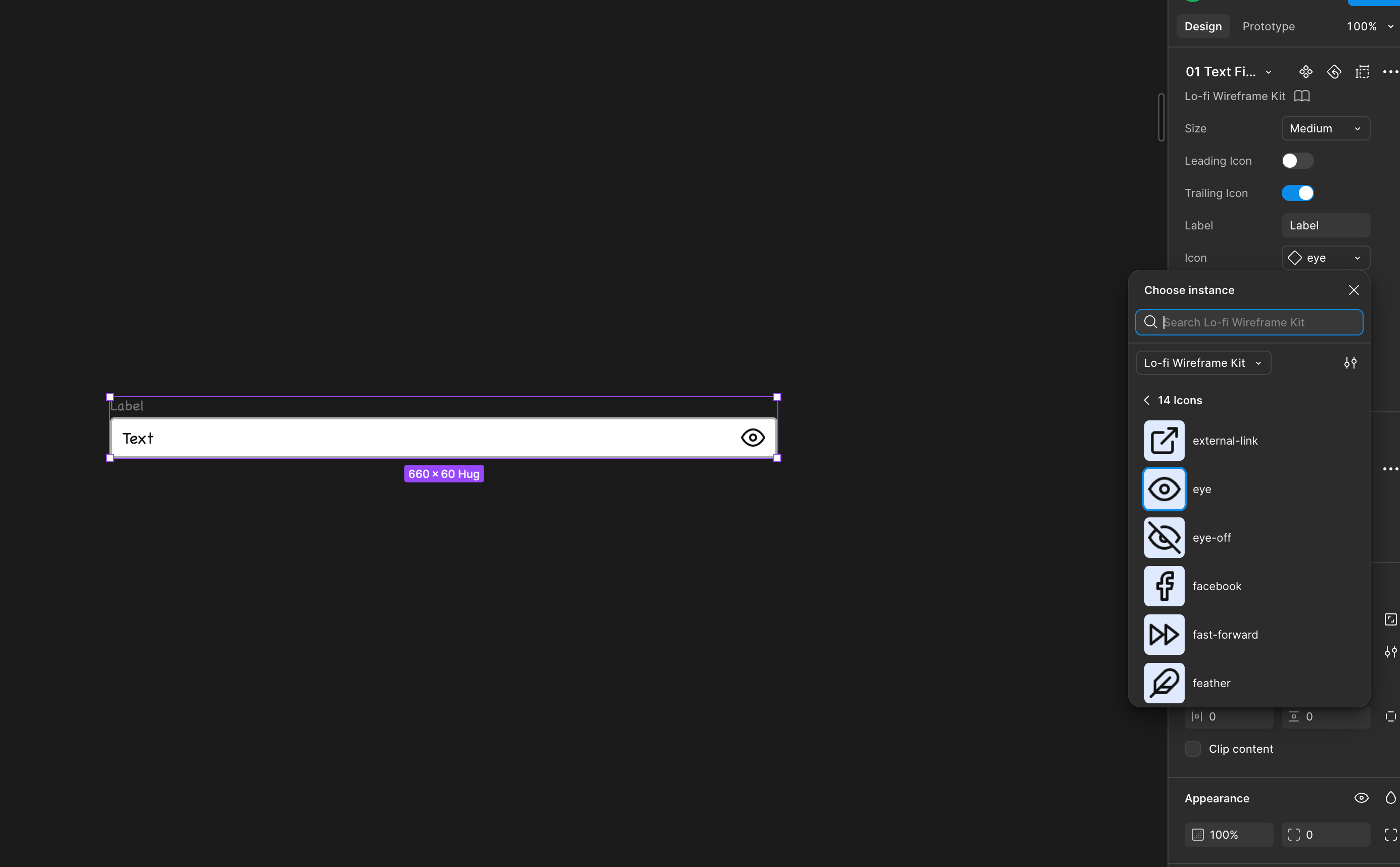

I assume the *real* issue is that you want to be able to freely swap between different icons inside a component. For that, you’d add a Component Swap property to the component you’re nesting the icon in. This will allow you to search for and choose whichever icon you want.
You can learn more about the component property feature here https://help.figma.com/hc/en-us/articles/5579474826519-Explore-component-properties
A component with the component swap property added
