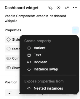

Juuso_Kantonen
Sep 1, 2025 11:44 AM UTC
It would help a lot with design handoffs and code generation if components would have metadata properties. There could be a specific property type for metadata that doesn’t affect the rendering of the component but can be used to pass key-value pairs that would appear in properties list in Dev Mode.
Few examples:
  • aria-label: “Save changes”
  • max-length: 16
  • Web component: <vaadin-dashboard-widget>
  • Component version: 1.2.1
I already thought that setting up a text variable that isn’t connected to any layer could be used for passing the info in a “hidden” property, but it will result an invalid asset due to unused property. The simplest workaround could be to support special markup for read-only properties. For example “_component: vaadin-dashboard-widget”. Ideally the values in metadata properties could be marked to allow editing to make them more useful (i.e. aria-label case).
Current property types
