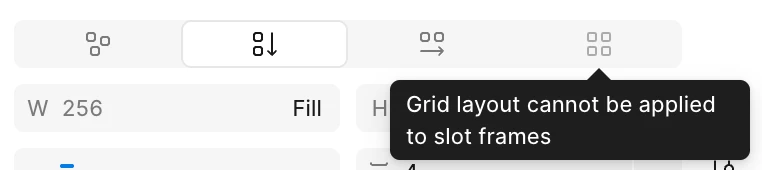

Will the grid layout be available within the new Figma Slots before the end of the Beta?

I’ve already started using the new slots and I find them amazing, but I think it’s very limiting to prevent the use of grid layout.

Hi folks! 🤠 I found a simple, not-too-hacky workaround for now. Wrap your Grid frame with an additional frame and then convert the outer one to a Slot. It works perfectly, but it does sort of undermine the Slot property in the properties panel, since you wouldn’t want to actually add anything there. Hope this helps!
Hi Samuel,
thanks, this does “work” and makes it at least behave like desired, but sadly no long-term solution as this is basically a detached component without tokens :/
Figma, please add support for grid, why would you remove it anyway???
