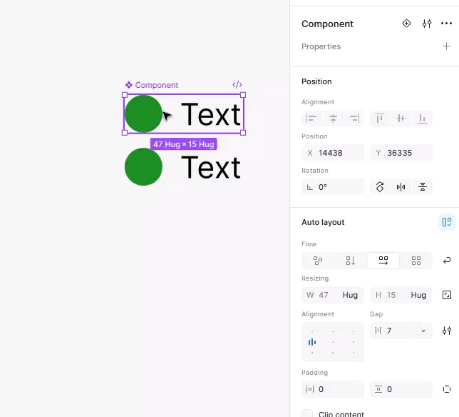

In my understanding of global components, when the Main component is made changes, it reflects in all instances automatically, but why is it that mine is not showing the changes?

    There could be several reasons. One of the most common is overriding. If you make changes in some part of a instance, this part won’t accept updates from the main component until you reset it.
    Ravneet K Dhillon
    Aug 7, 2025 8:16 PM UTC
    Or could it be because the main component resides in a different file? Though I considered the library on the file to use the assets but still it wasn’t reflecting the change until I had to bring the fresh instance from the recent change, then it worked.
    I am asking this for a clarity because in my library I am setting global components so they are used across teams keeping the same attributes and reflect any changes. If there is some step we’re missing for the goal then I’d really appreciate an insight!
    Thanks!

    Yes, it could. Make sure you have published the library and added it to your file. Also, when you make changes in the library, you need to publish it again and accept the updates in the destination file.

    Thanks guys, yes I missed the publishing step hence the issue. Got the clarity now!
