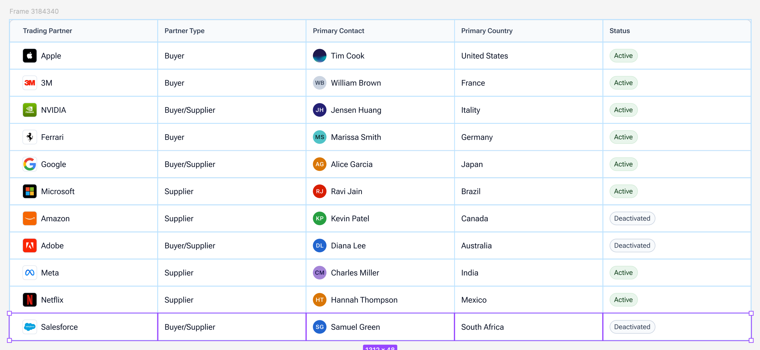

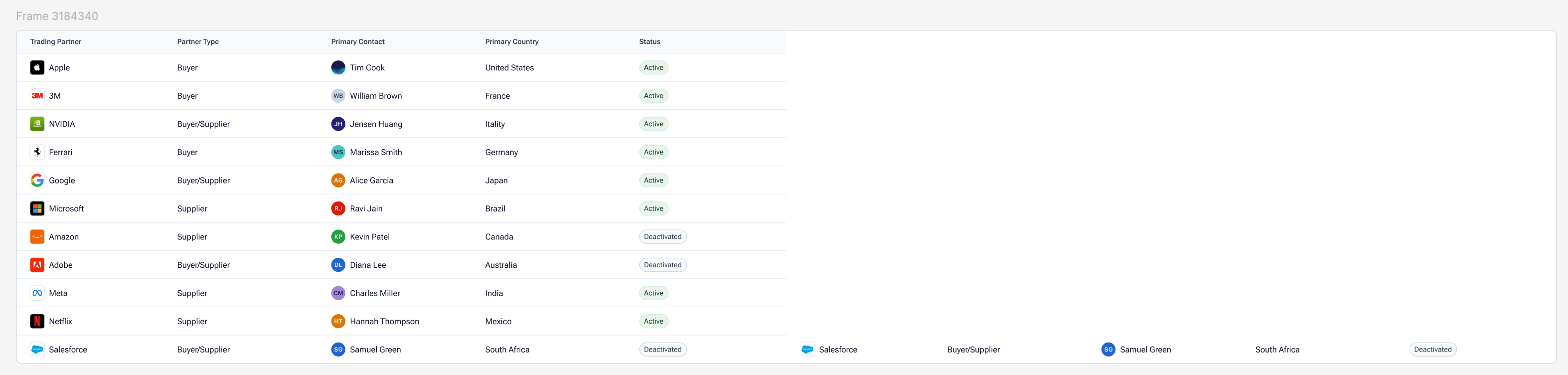

  • Table behavior
    • After I’ve manually selected each item in a row, now I’d like to create a new row, let me hit Cmd+D and...
      oh. This also happens in reverse when selecting an entire column. Tables to me seem like the most obvious use case of grid, because managing tables in Figma has been a pain for years, you either get nicely sized rows, or nicely sized columns, but now trying to use Grid for table somehow creates an even worse experience. Duplicating a row grants you more columns, and duplicating a column grants you more rows. You have to manually add the row/column first before duplication, and then it will work as expected.

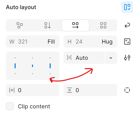

It’s annoying that Figma designer’s continue shift things around. Who thought that switching places of the gap width and the alignment was a good idea? Why?
