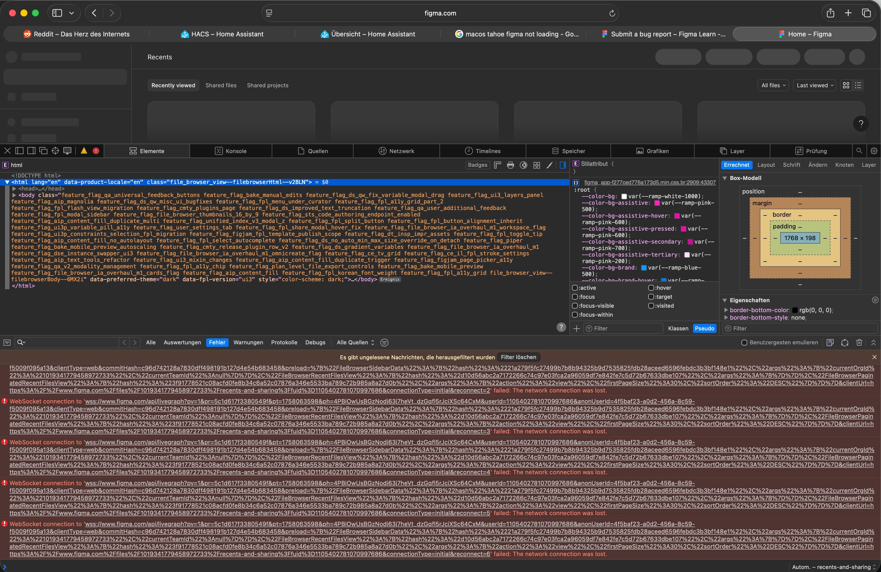

Safari MaxOS 26 sometimes not loading Websockets
I got a strange problem on my iMac M1 with Safari on macOS Tahoe.
Figma is somehow stuck in loadingstate - it seems there is a problem with the web sockets.
The strange thing is, on my M4 MacBook Air it's working. If I clear Website Data it starts working, but doesn't keep on working.
