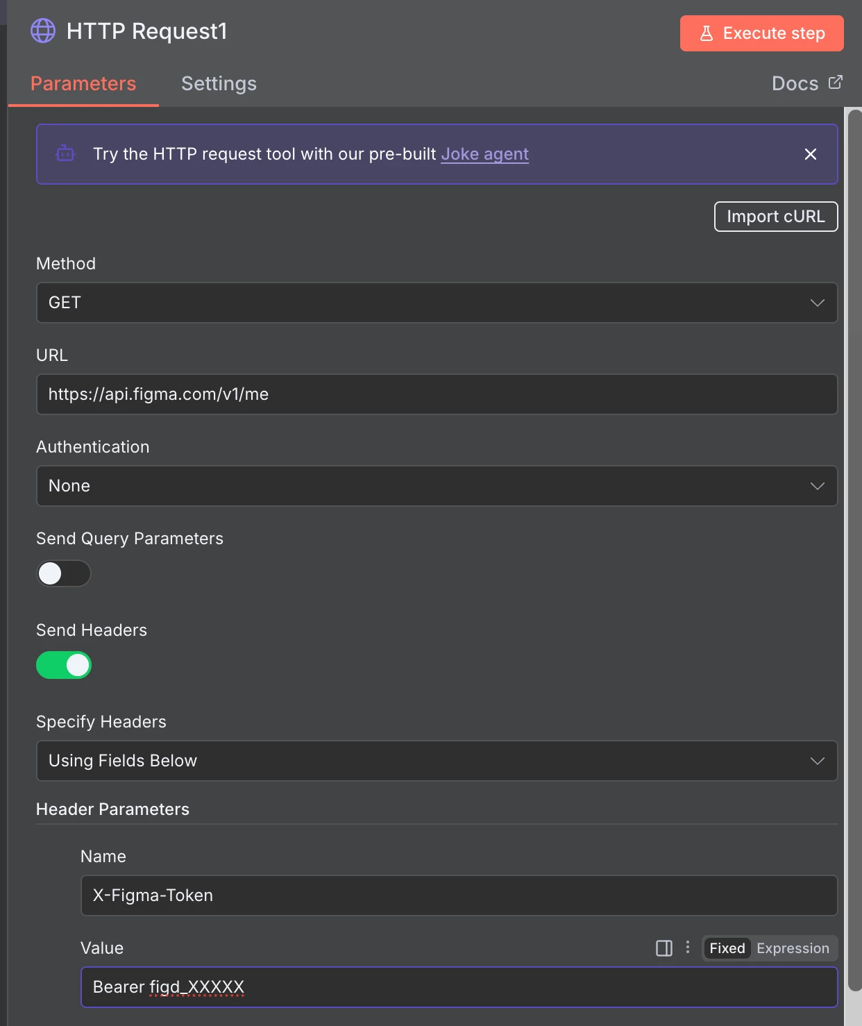

I keep getting a “403 - "{\"status\":403,\"err\":\"Invalid token\"}"” also via Postman when trying to send an HTTP request and use the REST API. Any solutions to this?
We are having the same problem with the rest API. We’ve made no code changes and all of a sudden the only response we get is 403
Hi
I sent this topic over to our API team, and they noticed that you have Bearer <token>
in the header parameter, this should just be <token>
without the Bearer
part. Hope that helps!
