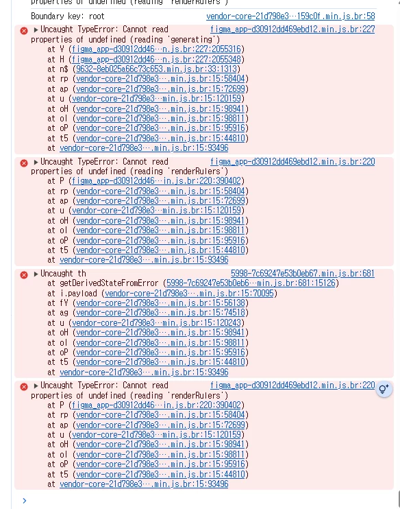

    I was able to capture a concrete console error when the issue occurs.
    When running a Make prompt on the affected project, the generation starts normally, but right near the completion stage (when the result seems to be applied to the file), the editor crashes with React error boundaries.
    Console shows repeated errors such as:
    • Uncaught TypeError: Cannot read properties of undefined (reading 'generating')
    • Uncaught TypeError: Cannot read properties of undefined (reading 'renderRulers')
    • getDerivedStateFromError
    This happens only on specific projects and is reproducible.
    Other projects work fine with the same Make prompts.
    This suggests a case where the Make execution / commit state becomes undefined for certain file states, causing the editor to fail during the final apply/render phase.
    I’ve attached a screenshot of the stack trace.
    I can also provide file URLs, Error IDs, and reproduction steps if needed.

    • Console shows errors like:
      • Cannot read properties of undefined (reading 'generating')
      • Cannot read properties of undefined (reading 'renderRulers')
    • Around the same time, POST /api/make/fetch_ds_code_gen_status returns 400 (Bad Request)
    This suggests an issue in the Make execution / apply (commit) pipeline for certain file states, rather than a general file corruption or memory-limit problem.
