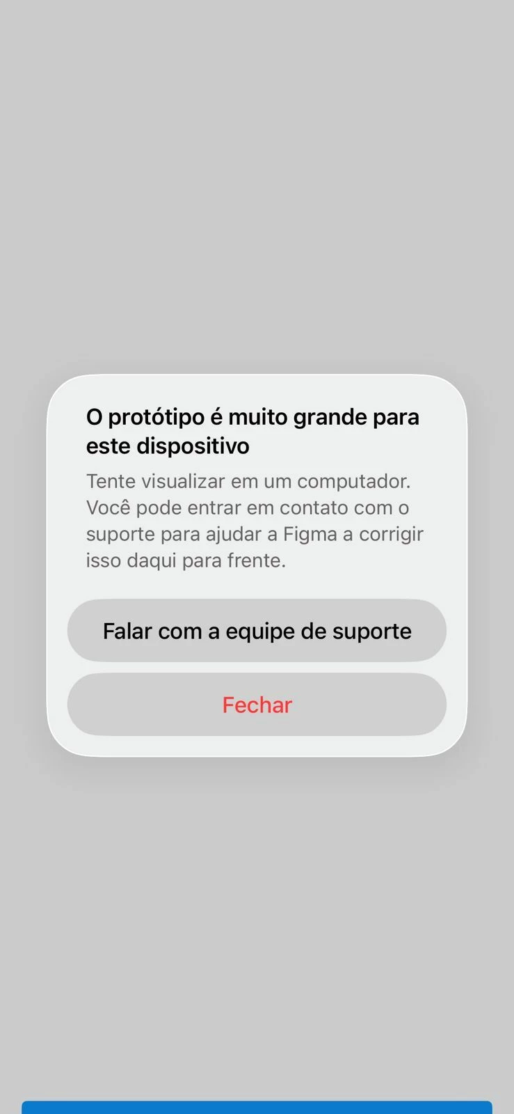

Não consigo abrir meu protótipo no celular
Ao abrir meu protótipo mobile pelo celular, recebo esse informativo que: “O protótipo é muito grande para este dispositivo”, que devo acessa-lo pelo computador. Porém, necessito mostrar o protótipo pelo celular para meu cliente. Como posso resolver esse problema?

Hey ​@Pedro Felipe, thanks for reaching out! At the moment, we don’t have official support in Portuguese, so I’ll continue in English. Please let me know if anything is unclear and I’ll be happy to clarify.
You'll see a message that the frame you are trying to open is too large or that your prototype can't be opened on mobile when loading this screen of your prototype, including connections and variant sets used in interactive components, uses more available memory than is available on your phone. You can read about how to Reduce memory usage in files and most of the suggestions there also apply to prototype loading on mobile.
Figma is a browser-based app, which means it's subjected to a 2GB available memory limit that applies to each browser tab, including those in our mobile app, or mobile browser. When loading or editing Figma files nears or exceeds this memory limit, it can cause performance issues like long load times or crashes, especially in a mobile browser, which generally has an even smaller available memory (the specifics depend on the phone model and OS version).
