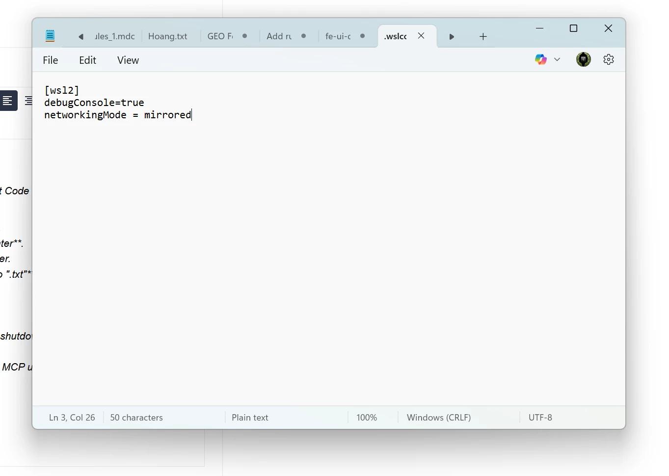

I ran into the same issue while configuring Augment Code under WSL 2 and found this sequence fixes it:
1. Press **Windows + R** to open the *Run* dialog.
2. Enter `%UserProfile%\.wslconfig` and press **Enter**.
   * If the file doesn’t exist, create it in your user folder.
3. Confirm the file is named **.wslconfig** (with **no ".txt"** extension).
4. Add the following lines and save the file:
   [wsl2]
   networkingMode = mirrored
5. Open PowerShell as Administrator and run: wsl --shutdown
After WSL restarts, you should be able to configure MCP using 127.0.0.1 without further issues.

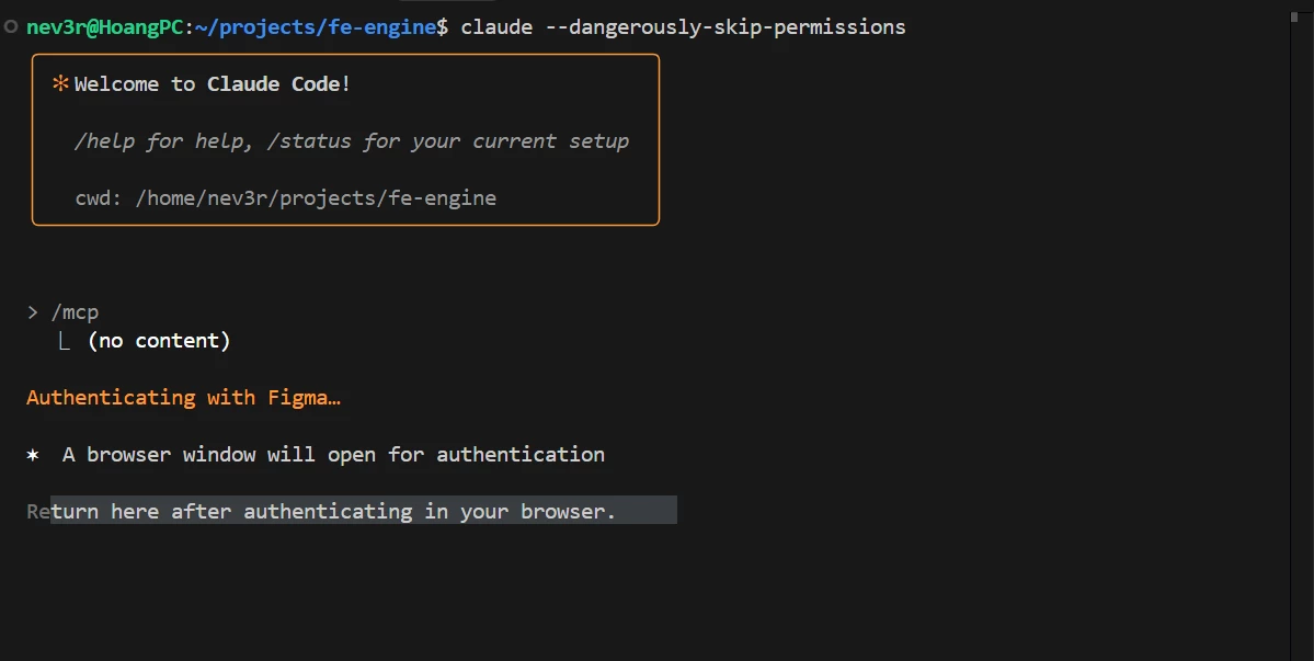

I have another problem it seem like I can connect, i got stuck on authentication?

So you fix the authentication issues?
You are my day saver
