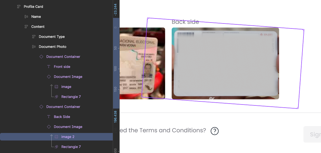

Hi Toku. Thank you for your response. I checked the layer panel for Design and indeed clicked on the rotated element; I confirm it’s the image. While it's a generic image, I completely understand your concern about security. I appreciate the clarification.
In sites file the layer panel is this.

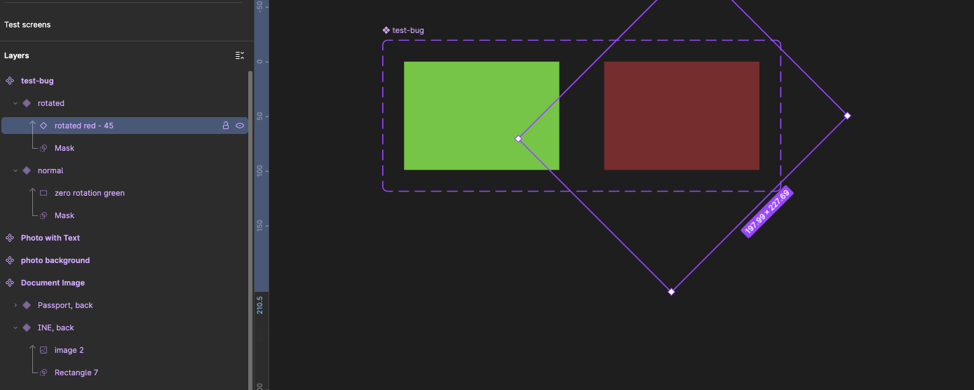

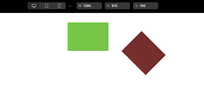

I tried to reproduce the bug by creating two rectangles: the green one has no rotation, but the red one does. I masked them inside another rectangle and moved the component to Figma Sites. In the preview, the red rectangle also appears rotated.

Hi ​@emoreno,
I've passed this along to our internal team as I think I was able to reproduce the issue on my end. I'll keep you updated if there is anything I can share!
