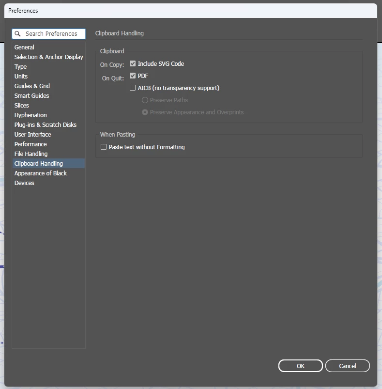

StressCreative
Its an illustrator 29.7.1 change, just go into preferences and turn on “Include SVG Code” should be gucci, I am now gucci.

Rafael Empinotti
Changing Clipboard Handling preferences and checking 'Include SVG code' in illustrator no longer works
Illustrator Version: 29.8.1
Figma Version: 125.8.8
