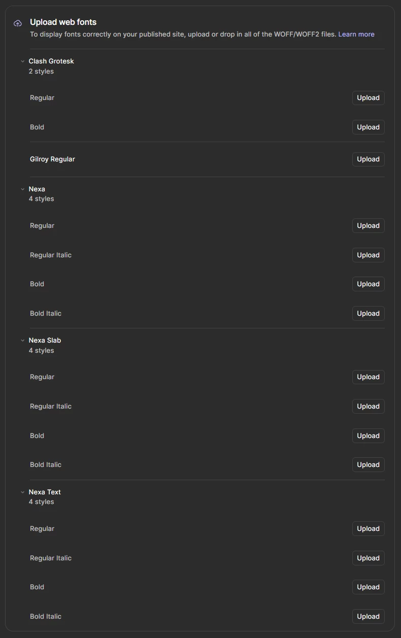

Josh_M
Hi, I’m having trouble uploading specific custom font weights to my Figma Site. My site doesn’t need all of these fonts but, once I started having issues uploading certain font weights, I wanted to test how many were unreadable/incompatible. All of the font weights listed are used in my Figma Site but Figma says it “doesn’t match any font in use” when I go to upload the corresponding woff2 file.

Hi ​@George_Zhang, yes, certain styles are uploading while others are not.
  • Everything but Nexa Regular and Bold it seems (thin, extra light, light, book, extra bold, black, heavy all upload just fine)
  • Neither WOFF or WOFF2 work
  • Installed as system fonts, downloaded from MyFonts
  • 3FR8vcAkp20XP6rmQo5mDz

@Josh_M sorry for the late response here!
From our logging, it looks like at one point on that file, the uploaded font was `Nexa Text` while the fonts in use were `Nexa`, which caused some uploads to fail.
I don’t have the Nexa fonts, but when I used a set of trial fonts for Nexa, the uploads succeeded for me. Could I trouble you with emailing me an example of an OTF/TTF and WOFF/WOFF2 pairing that’s not uploading successfully at george.li.zhang@figma.com? That would be really useful in digging in further.

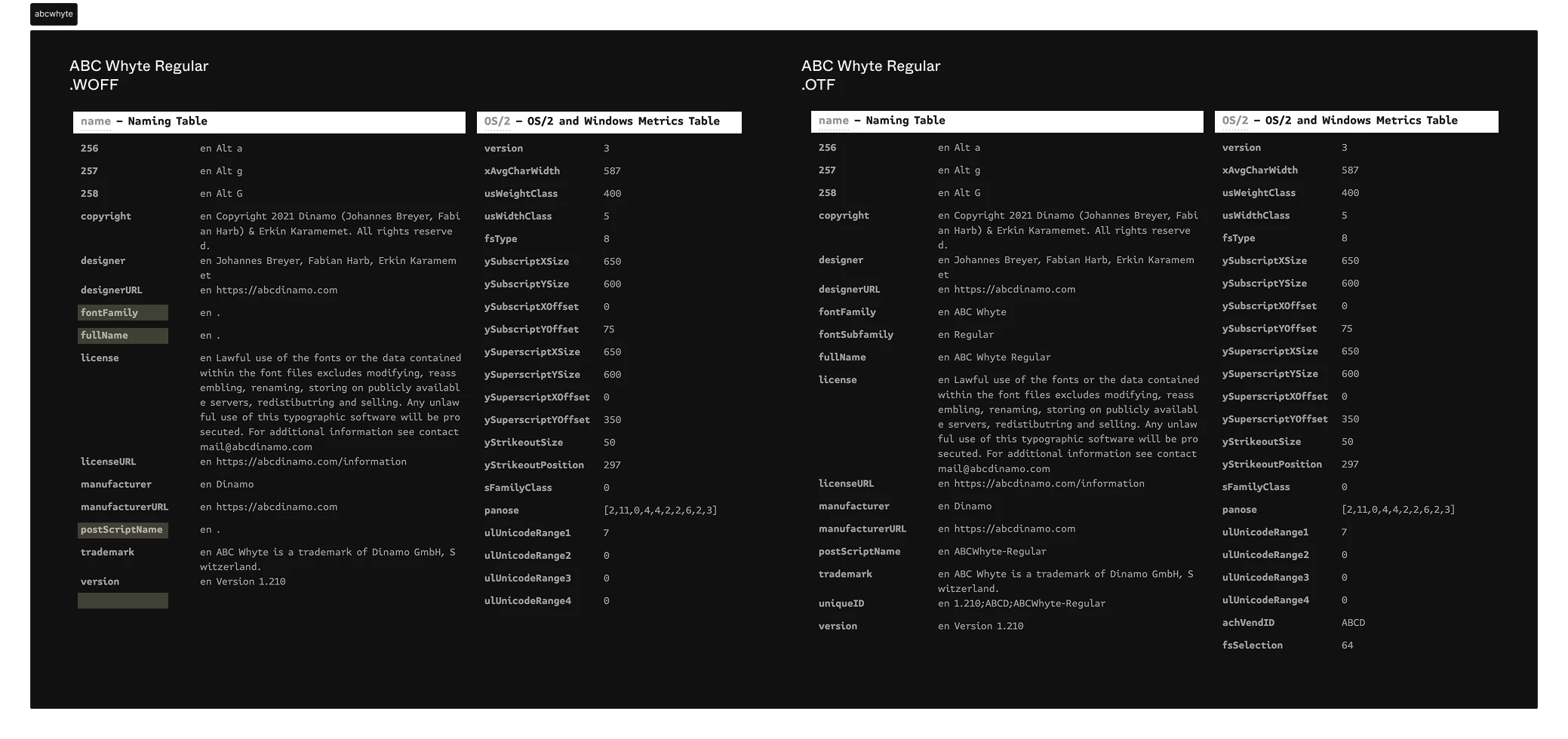

Katarina K
  • New Member
  • November 10, 2025
Hi ​@George_Zhang ,
I am having the same problems with the ABC Whyte and ABC Whyte Inktrap fonts, in all font weights.
In FontDrop, I see the WOFF and WOFF2 files don’t have a defined fontFamily and fullName, and are missing a uniqueID (screenshot attached). Will I ever be able to use them with Figma Sites? Is there any workaround, or are my fonts just broken :-/ ?
Thank you!

Hi ​@Katarina K, sorry for the trouble!
The workaround would be using a conversion tool (e.g. OTF to WOFF2), and uploading those files as the web fonts since they’ll have matching metadata with the in-editor fonts.
