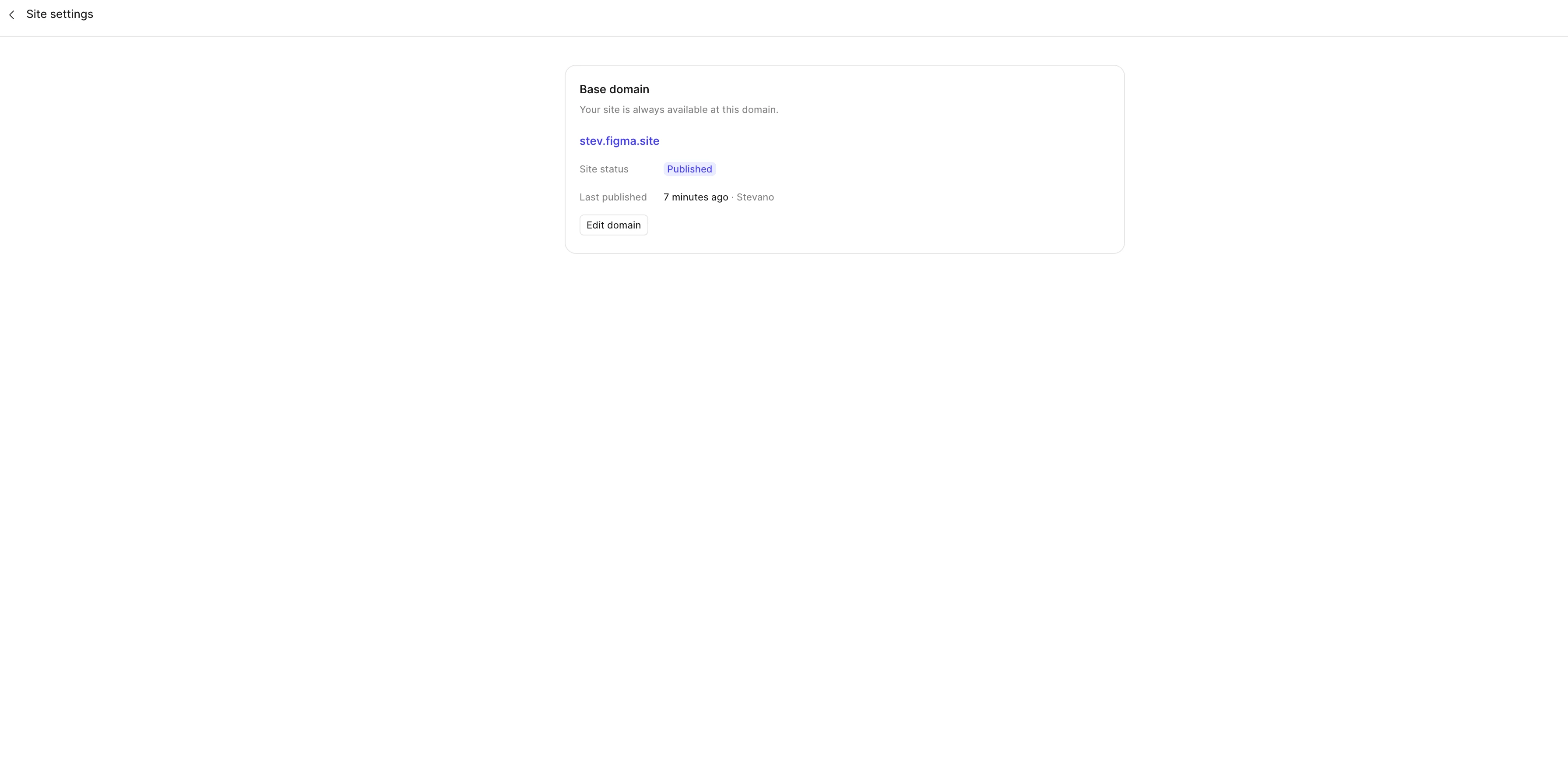

Stevano
  • New Member
  • September 24, 2025
Hello ​@Gayani_S, there is no Connected Domains option on my site setting for me
