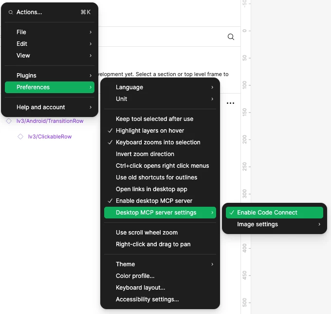

Turns out that it only respects the setting on Figma Desktop here:
So can you help looking into it?
Perhaps it’s a bit weird by design that you have a setting on the Figma Desktop preference, but also a `forceCode` flag, so one will be ignored. I would expect the `forceCode` to have the priority, but it’s actually completely ignored.

Were these the results you received when running the following settings in the Figma Desktop app?
  1. (forceCode parameter > true) — with “Enable Code Connect” checked
  2. (forceCode parameter > false) — with “Enable Code Connect” unchecked
If so, just to confirm, the code returned in case 1. (with “Enable Code Connect” checked) was not what you expected — is that correct?
Once you confirm, I’ll share this with our internal team for further review.
