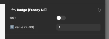

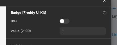

But, when clicking on the Badge component “tag” in the code (see image below), I was taken to the preview of the Badge, where I found out this component preview not only had the old name (more than 6 months old since we updated all component naming convention—image 2), but also the property names were also outdated (see image 2, where still using the old emoji system, which we don’t use for a long time, compared to image 3, the new and more recent one).
image 1 - Badge now showing in the code output
image 2 - old naming
image 3 - new naming
All my files and components are published and being used by other designers, and I don’t seem to see where the old name is coming from—this is why the error was shown in the first place, as the name of the prop was using an emoji, but the component doesn’t use it anymore.
