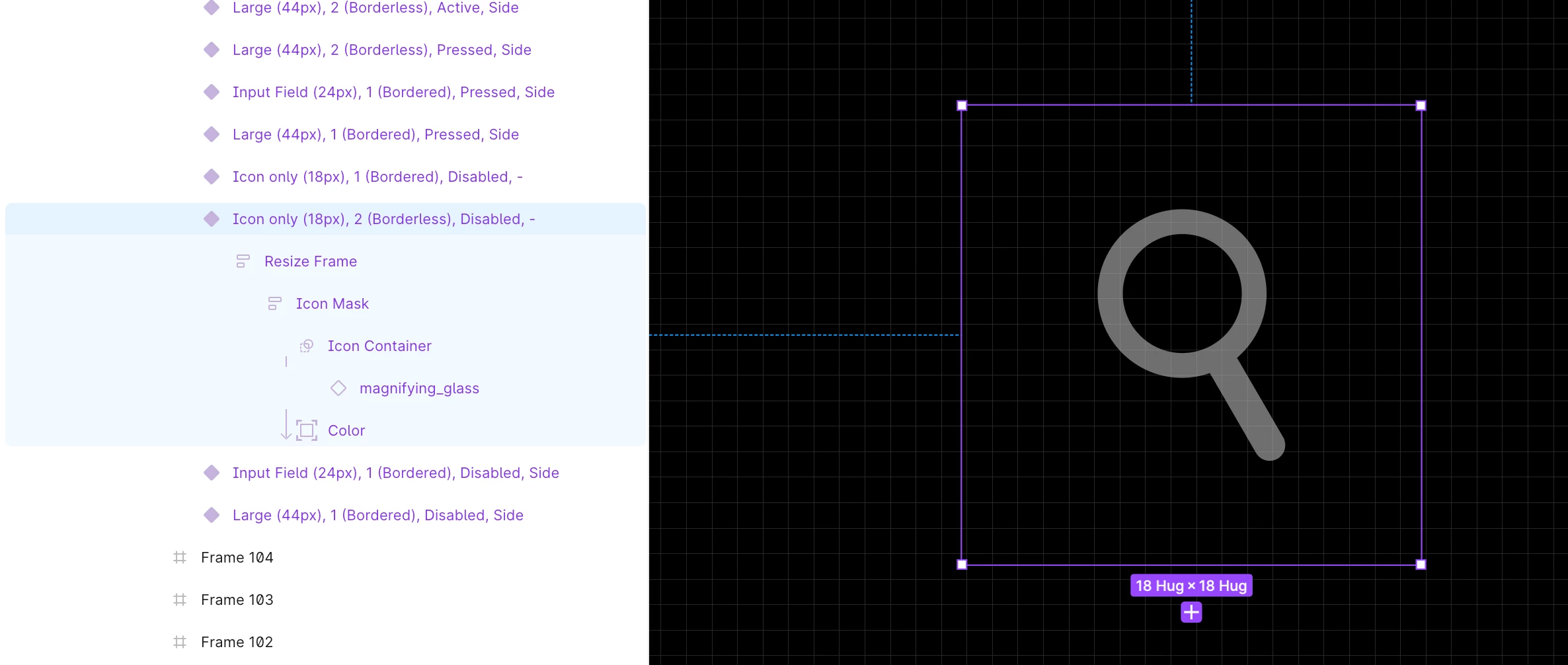

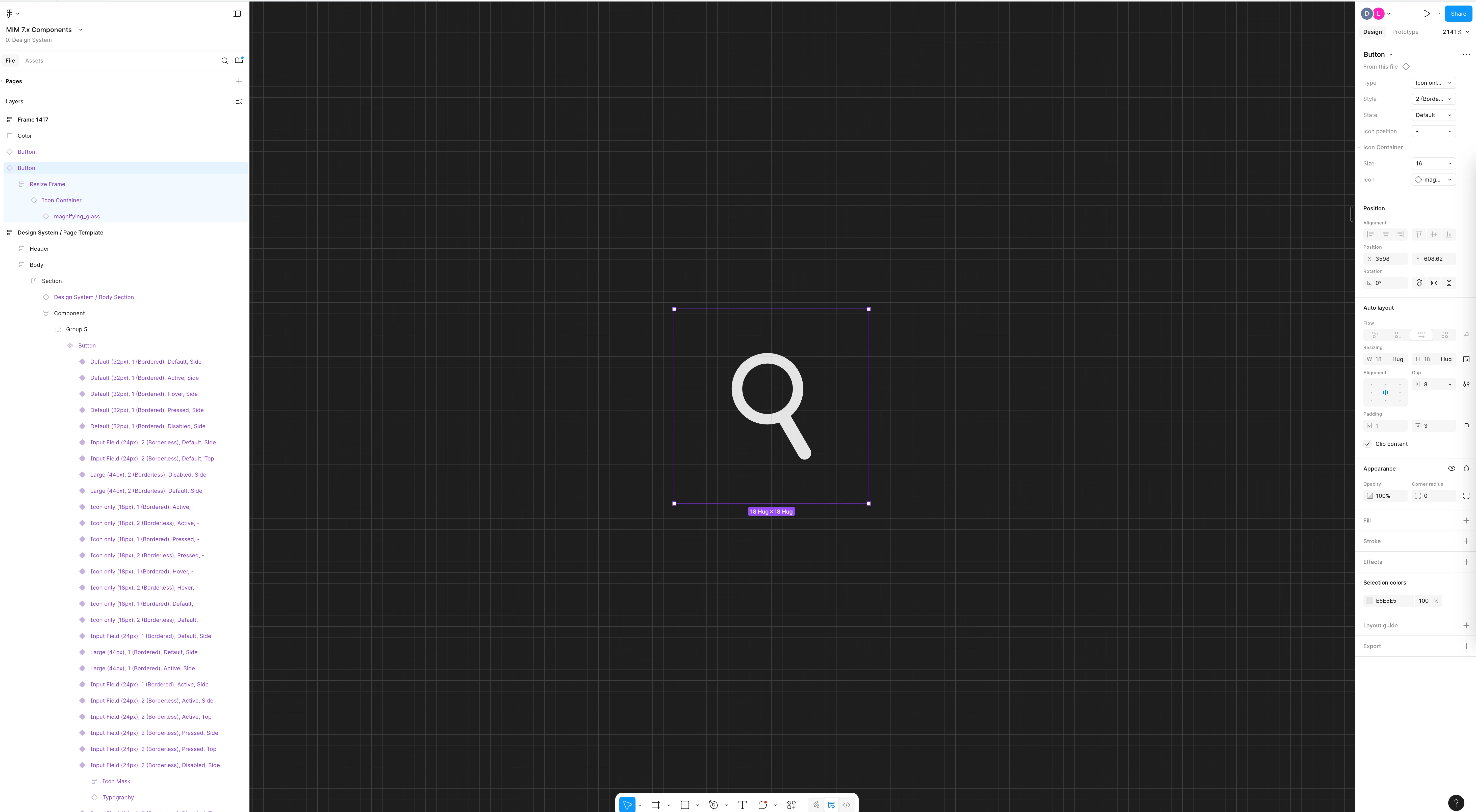

What the mockup looked like BEFORE July 31st at 10:43 AM

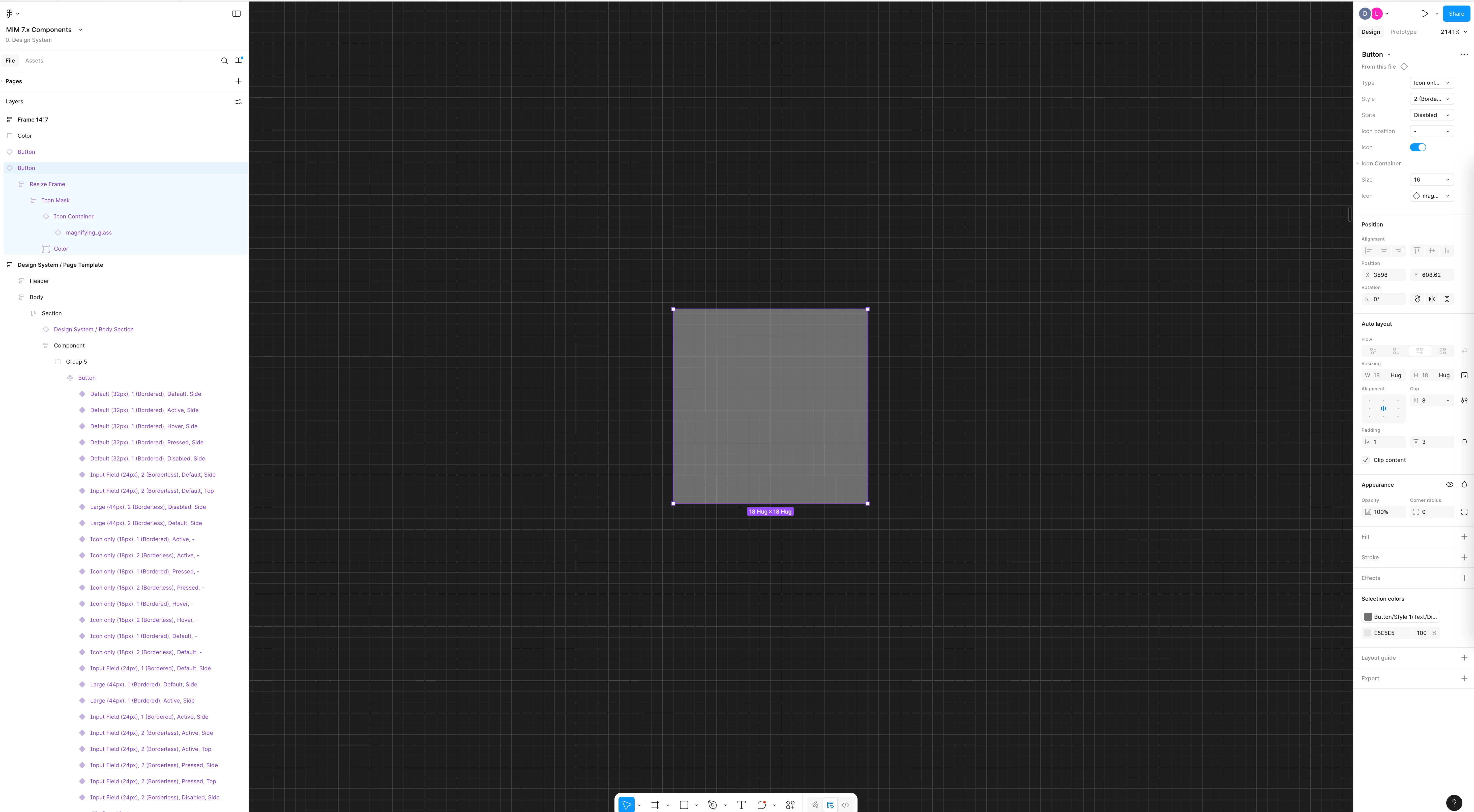

What the mockup looked like AFTER July 31st at 10:43 AM (today). All the masks are broken. The icons just look like gray rectangles.
When I attempt to copy the icons from a previous working version and paste it into today’s version, all of the components are detached and icons are missing. It is just empty frames.

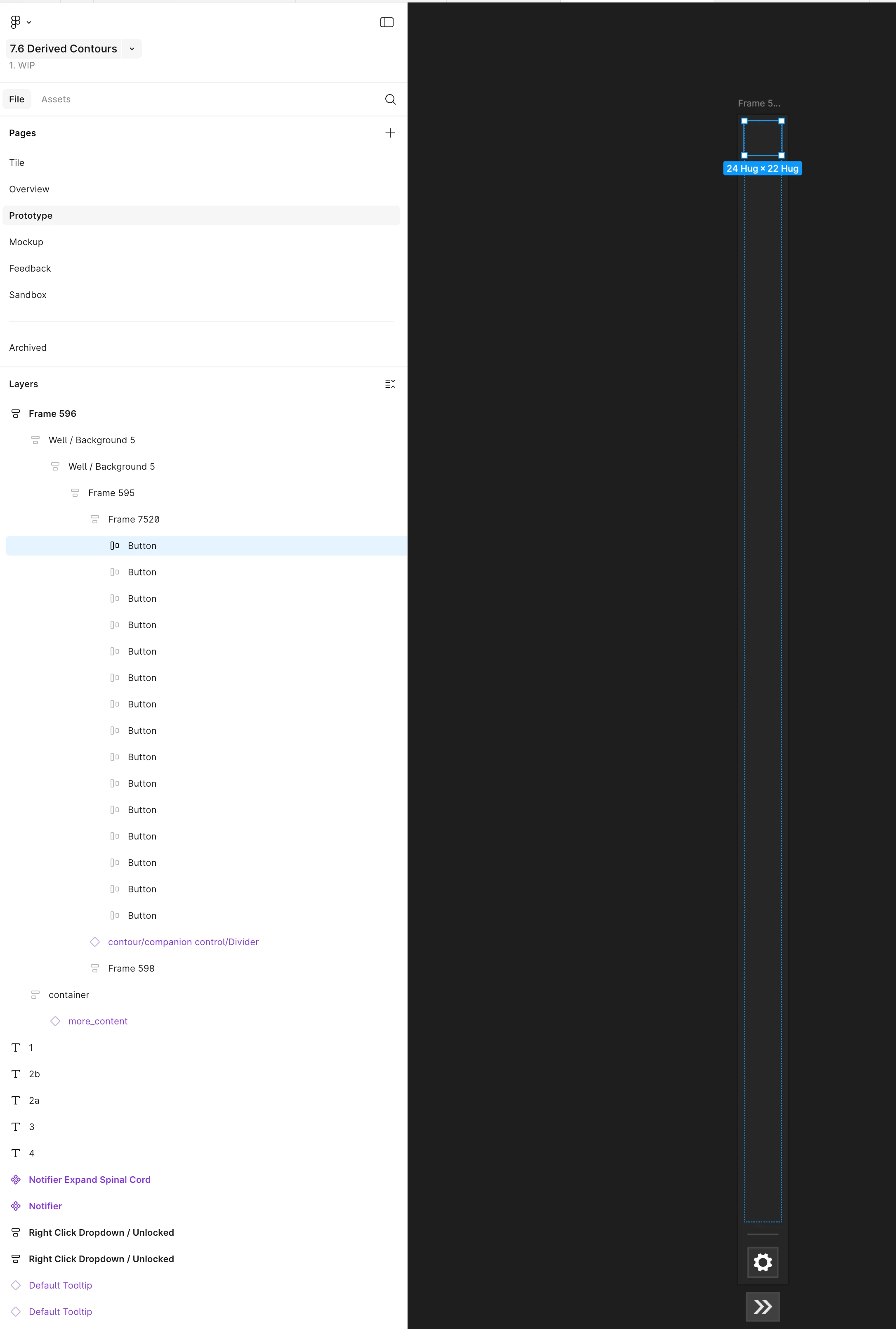

Original component layers (today)

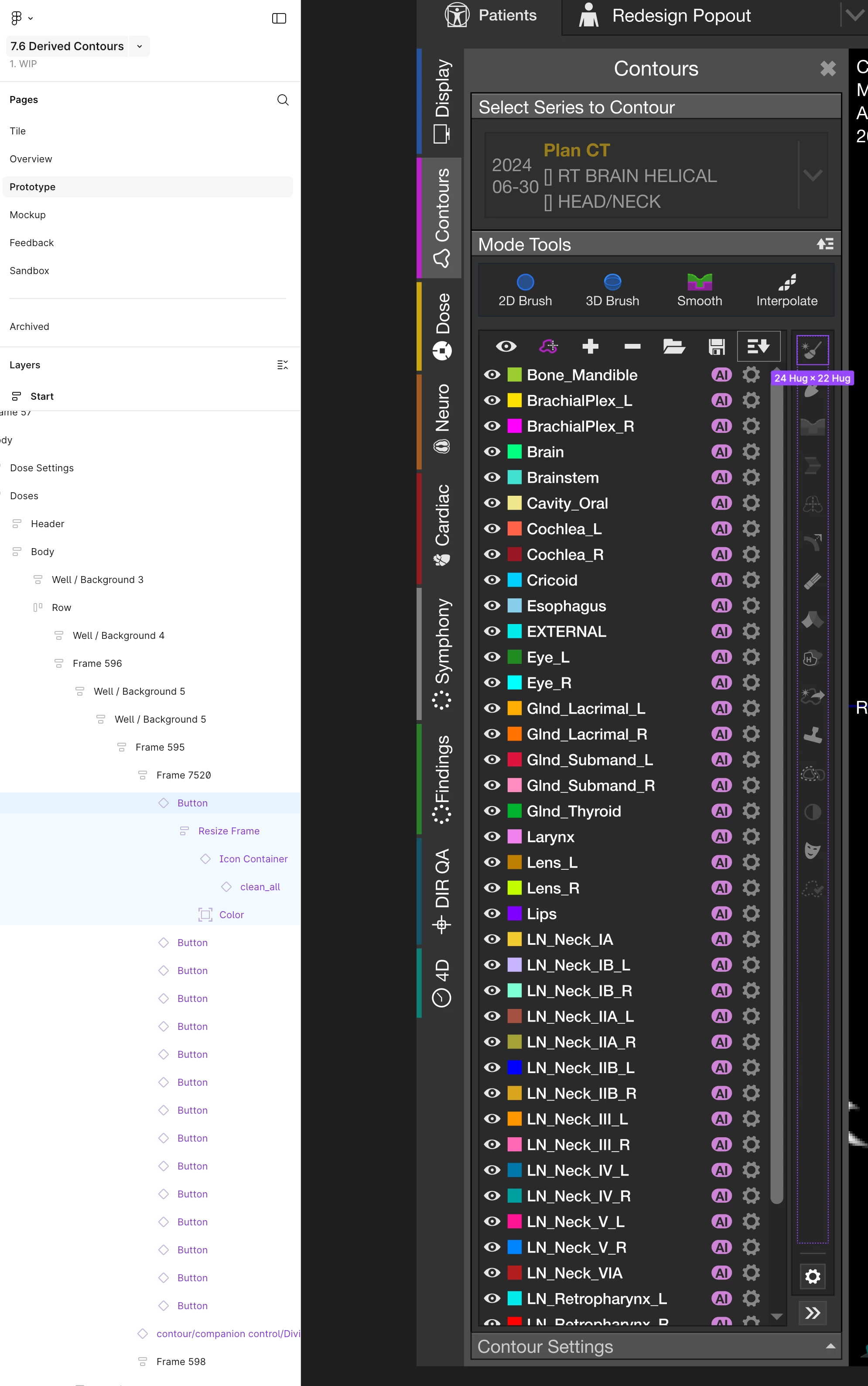

Component in default state (today)
Component in disabled state (today)

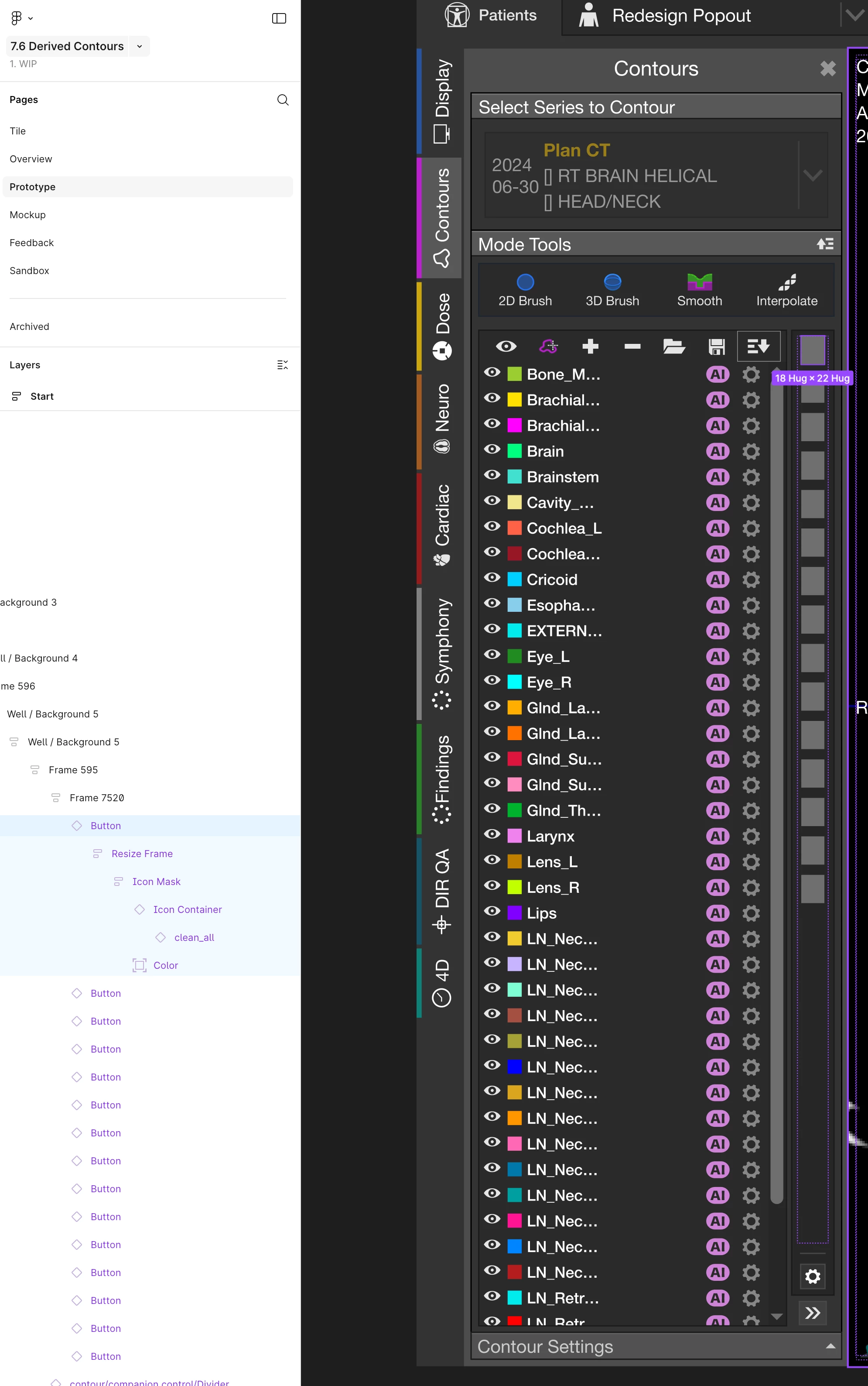

Additionally, resizing the nested icon no longer works. It’s difficult to show the history of this working, but this was a problem I worked on solving before and made sure resizing was working. You can see in the last two screenshots we have a nested component where you can select the icon size.
