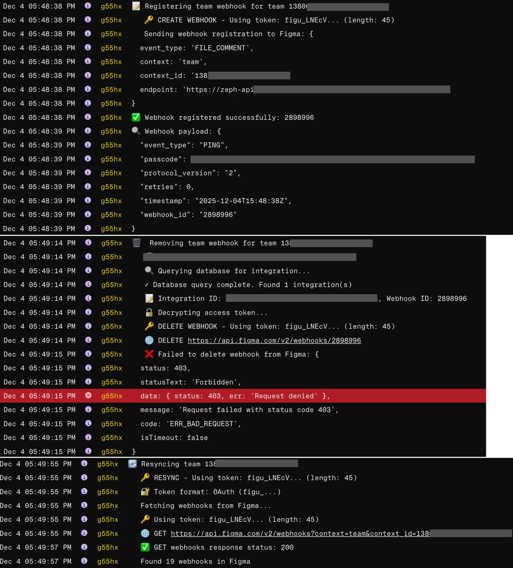

I’ve created some extensive logging in order to hopefully illustrate the issue better. My main hypothesis was that there was something wrong with my OAuth integration and it was using a different token, but as you can see from the logs that is not the case.
The token is valid and upon obtaining it (when I add the team in my app) I immediately use it to register a webhook – this part works, however when I immediately try to delete it afterwards I get the 403.
Is there some hidden ownership model where webhooks are tied to a specific OAuth session/token, even if it's the same user and app? Because that's the only thing that makes sense to me at this point.
