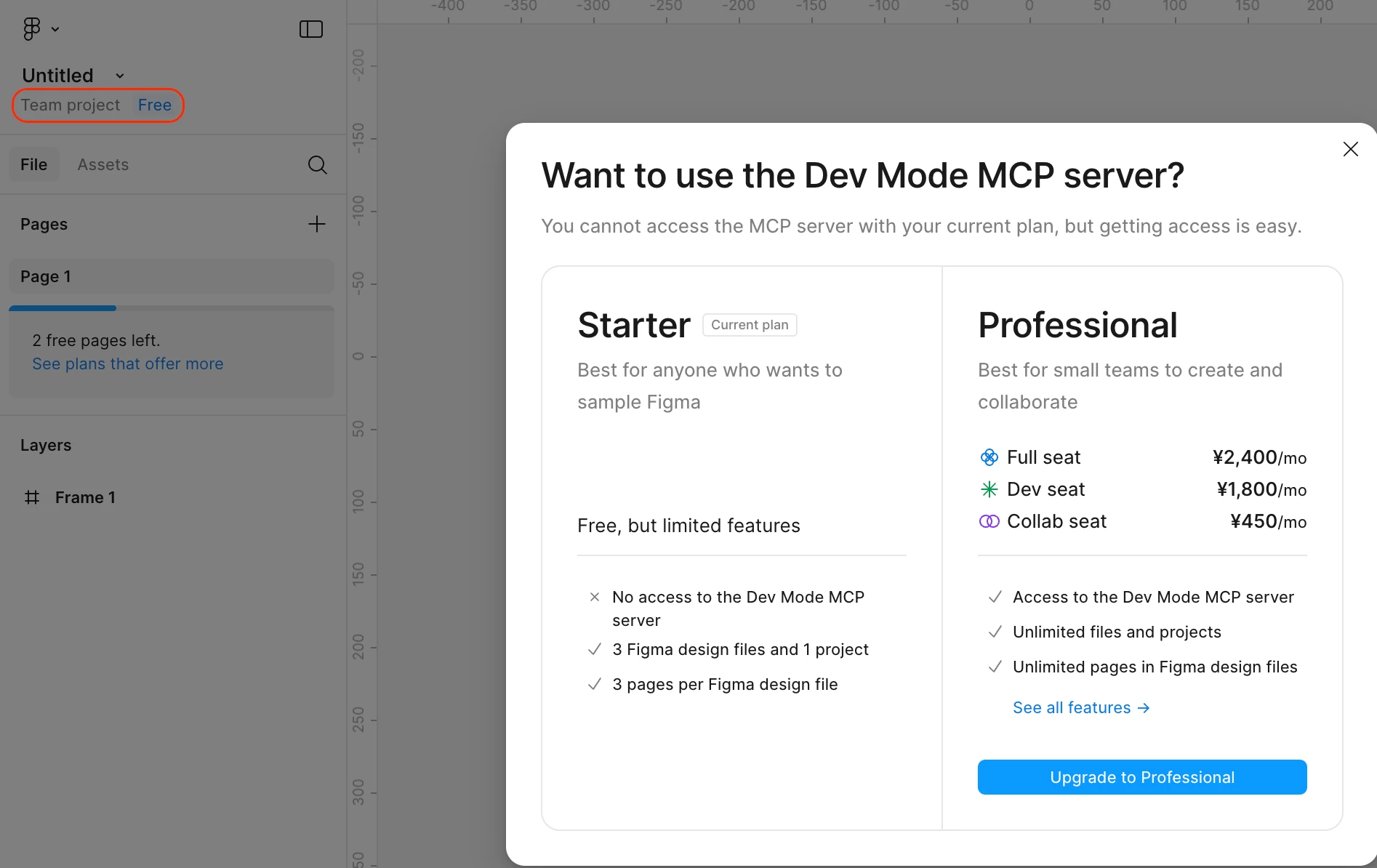

'enable local MPC server' opened a pop up saying I was on a Starter plan. I followed the link and bought a Professional Full Seat but the same pop up come up when I try 'enable local MPC server'

I understand you're seeing a message saying you're on the Starter plan when trying to enable the MPC Server, even after upgrading to a Professional Full Seat.
I took a look and it seems you have access to two different teams — one on the Professional plan and another on the Starter plan.
Could you please double-check that the file you're trying to use the MPC server with is located in your Professional team? You can switch between teams from your file browser. Here's a quick guide on how to do that: Guide to the file browser > Your side bar > Team
