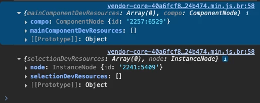

  6. Run the following code via the same plugin used in step 2:
    const node = figma.currentPage.selection[0];
    const resources = await node.getDevResourcesAsync();
    console.log(resources);
Expected Behavior: The API should return an array containing the Dev Resource objects (inherited from the Main Component), matching what is displayed in the Dev Mode UI.
Actual Behavior: The API returns an empty array [].
Visual Evidence (Attached):
  • Screenshot 1 (Console): Shows the plugin output returning [] for both the instance (selectionDevResources) and the main component reference.

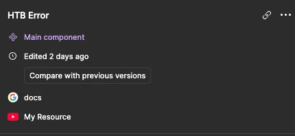

  • Screenshot 2 (Instance UI): Shows the Instance in File B clearly displaying "docs" and "My Resource" in the Dev Mode panel.

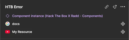

  • Screenshot 3 (Main Component UI): Shows the original Main Component in File A with the same resources.
    UI Dec resources on File A (Published Library)
