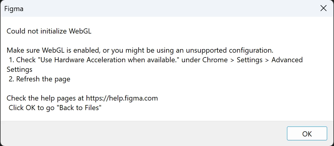

Since today's update, the application displays the error message: "Could not initialize WebGL".
This problem is highly likely related to the GPU/driver detection in the latest version of the app.

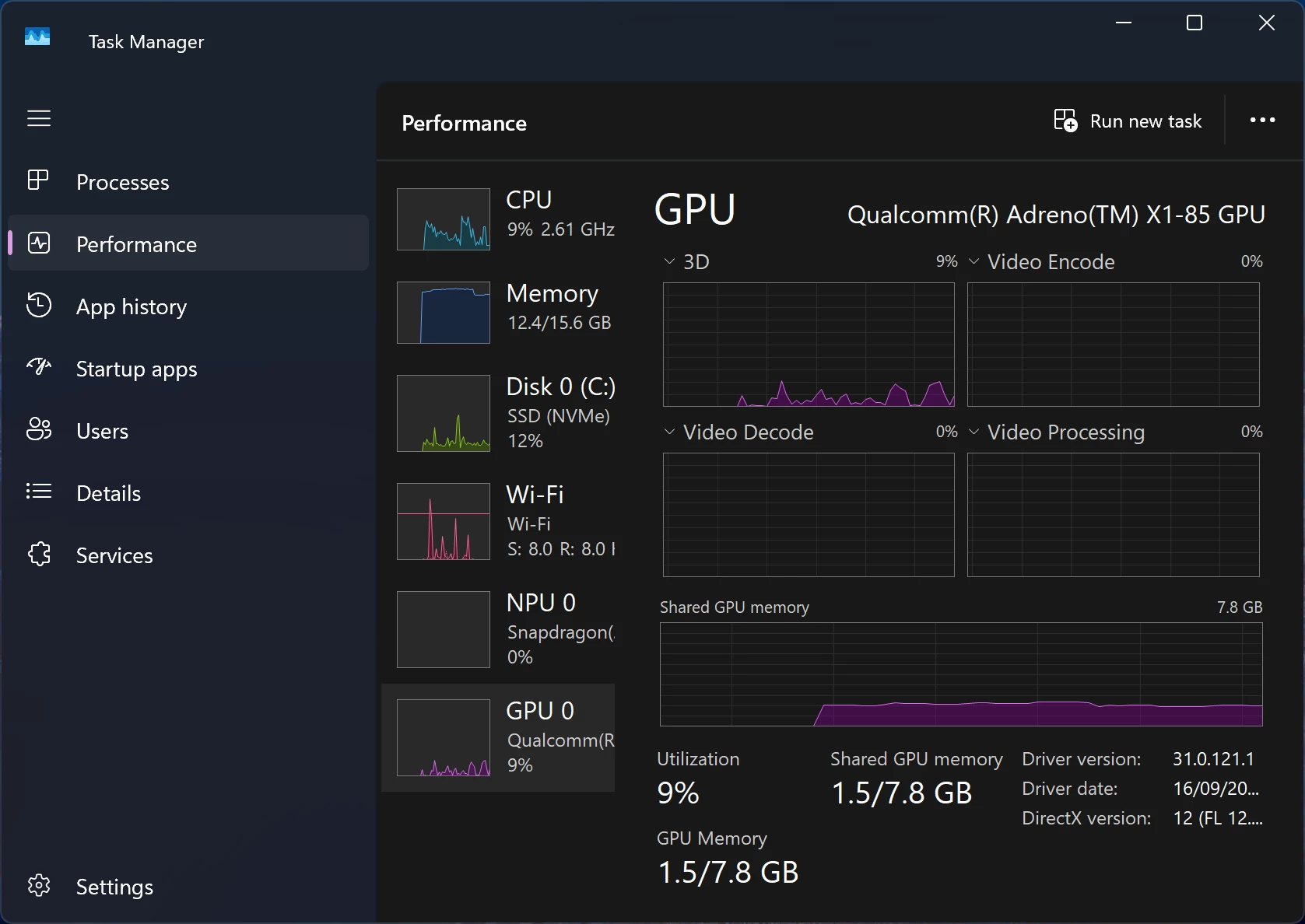

My Configuration:
  • OS: Windows 11 ARM64
  • Device: ASUS Vivobook S15 (Snapdragon X Elite)
  • GPU: Qualcomm Adreno X1-85 GPU
  • Adreno Driver Version: 31.0.121.1 (the latest installed via Windows Update).

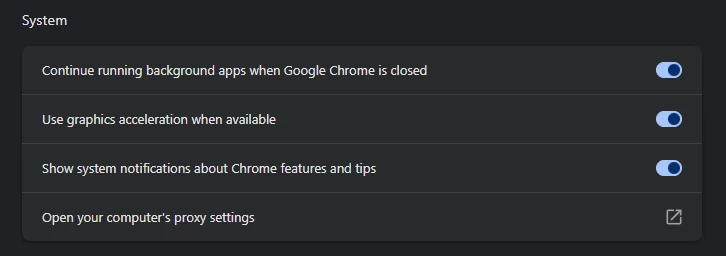

  1. WebGL works perfectly when I use Figma in my browser (Chrome/Edge).
  2. The error occurs only on the Figma Desktop application.

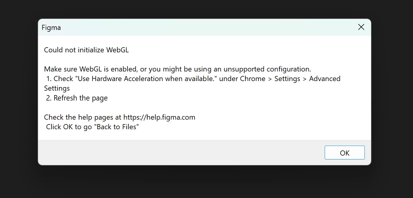

Dandi Feng
  • November 17, 2025
@djv Following as I have exactly the same issue.
My specs:
Lenovo Yoga
ARM64
Snapdragon(R) X Elite as well
OpenCL, OpenGL, and Volkan Compatibility Pack is installed.
Attached screenshot for reference of the error.
Dandi Feng
  • November 17, 2025
Update with more info: the screenshot is for when launching the design file.
Following the dialog box message does not resolve the issue. Still unable to launch design files in desktop app.
Husna Moetiaputri
hi ​@djv i have exactly the same issue. i use figma desktop, but always show the pop up “could not initialize WebGL”
