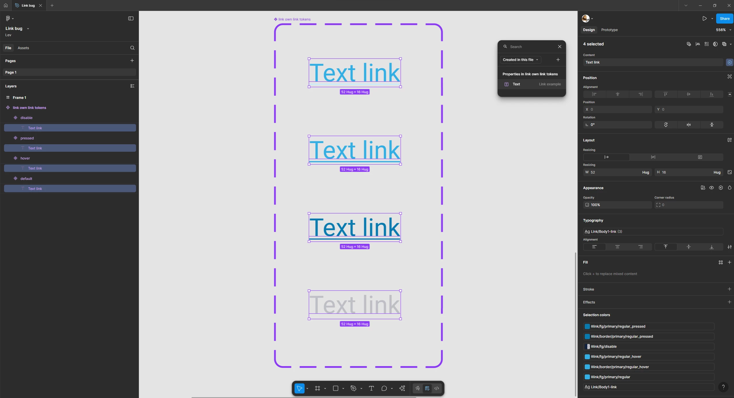

I created a new file with a component containing only text - "Link".
The component variants differ in the font colors used and the underline color.
For each component variant, the text underline colors are configured.
The text underline is pre-configured using a separate style from the design system library.
The result is a component with 4 variants.
As shown in the screenshot, each underline for the variant is different.
Example of custom underline style

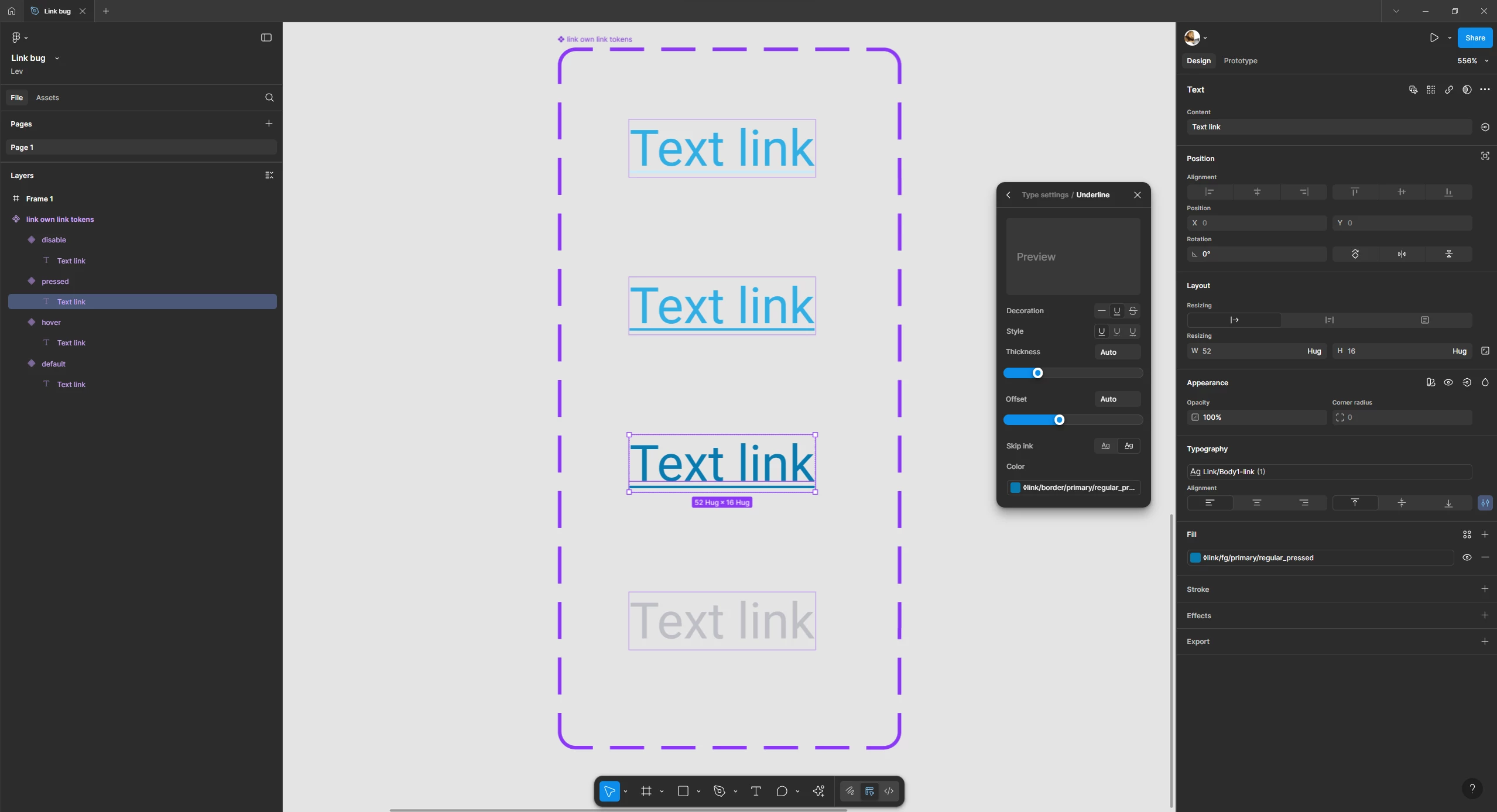

After that, I create text property to use a single text when switching component variants.
Creating text property
I apply the property to the text in the component
select the new text property for each texts in component

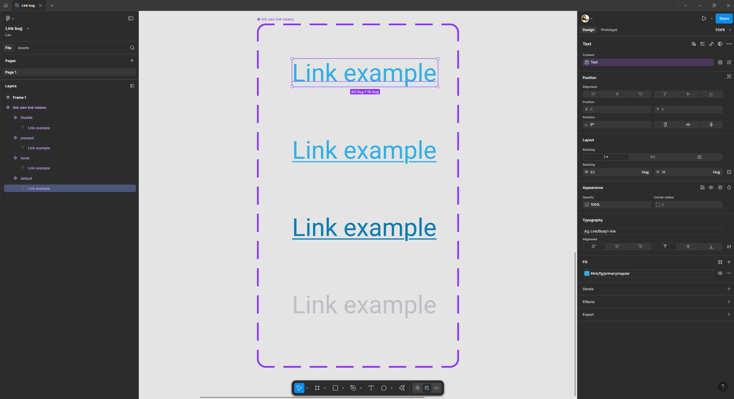

Success
But after changing the border of one component variant, a single style from the changed variant will be applied to each of the variants.
bug
The problem gains more weight if the component has a larger number of properties: sizes, states, display types.
Where each component variant is unique.
