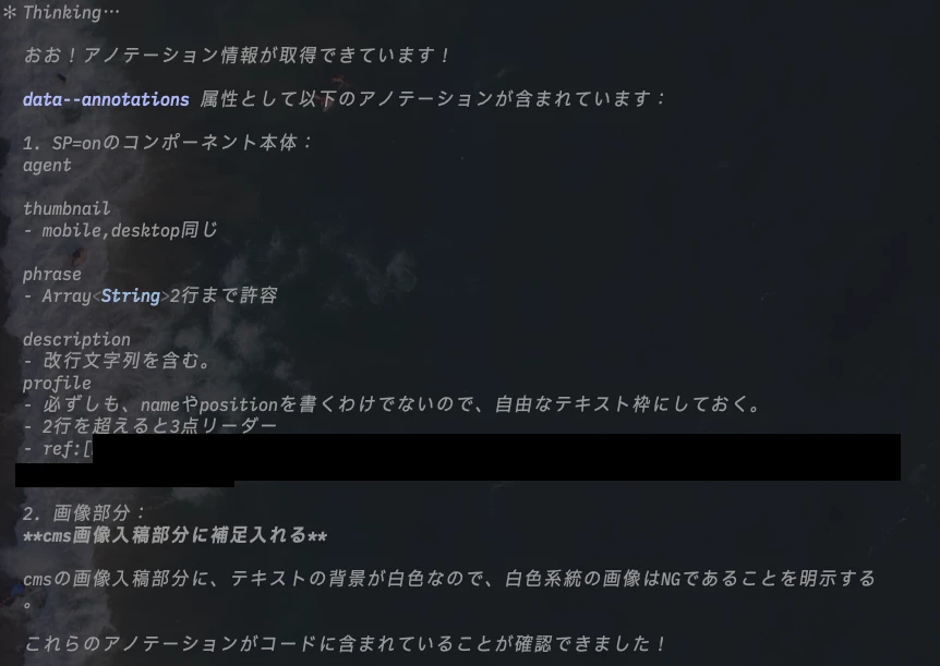

Kiichi Sugihara
I’ve also been using Figma MCP and encountered a reproducible issue with the get_code function. In my testing, it consistently fails when the selected element contains annotations. However, if I remove all annotations from the selection, get_code works correctly.
Just wanted to share this in case it’s useful as a reference for debugging or future improvements on the Figma side. I’m not looking for advice or feedback—just hoping this helps with identifying the cause.
Today’s Figma update has at least solved my problem.
Thanks! I’ve confirmed that I can successfully retrieve the annotation information as well.
The image below is an example where I used Figma MCP to fetch information into the Claude Code. I’ve confirmed that the annotation information can be retrieved.
