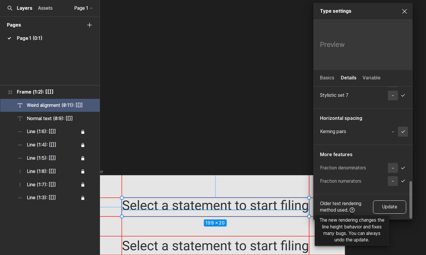

I have 2 texts in this file.
Those both have the same height, font, width, alignment. But one of them looks like having actual line height shorter than the line height set to it.
You can see the file above. Although I am not sure you would see what I see, so I did record a video: select them both, then change the vertical alignment.
The question is: What can cause this problem and how to fix it?
That weird alignment text is from a component that I have used in several files. And I don’t want to replace it with a new text layer because it may cause unwanted text reset.
tank666
  • April 4, 2024
One of the text layers uses the older text rendering method. Update to use the new rendering method.
You can find out more about the cause and its solution in this Help Center article:
Figma Learn - Help Center
