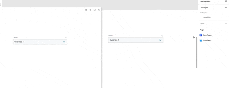

Consequently, its menu text keeps reverting back to the default copy “Menu Item” in the prototyping version, rather than my override text (the left window is Figma’s prototype preview).
CleanShot 2023-09-11 at 09.29.52

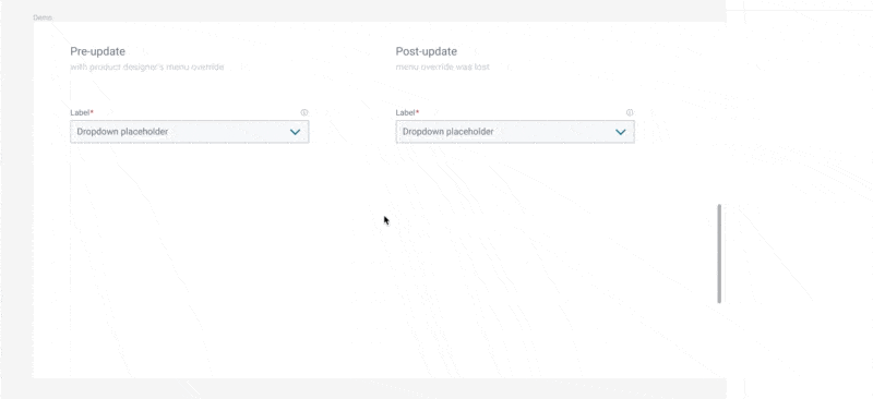

So I decided to paste a hidden menu into the close state. However, I did some publishing tests and discovered if I add a hidden menu, it will reset the copy of all the existing instances on project files because I assume the open state will now inherit the default “Menu Item” from the close state, rather than keeping product designers’ overrides.
CleanShot 2023-09-11 at 09.47.14
