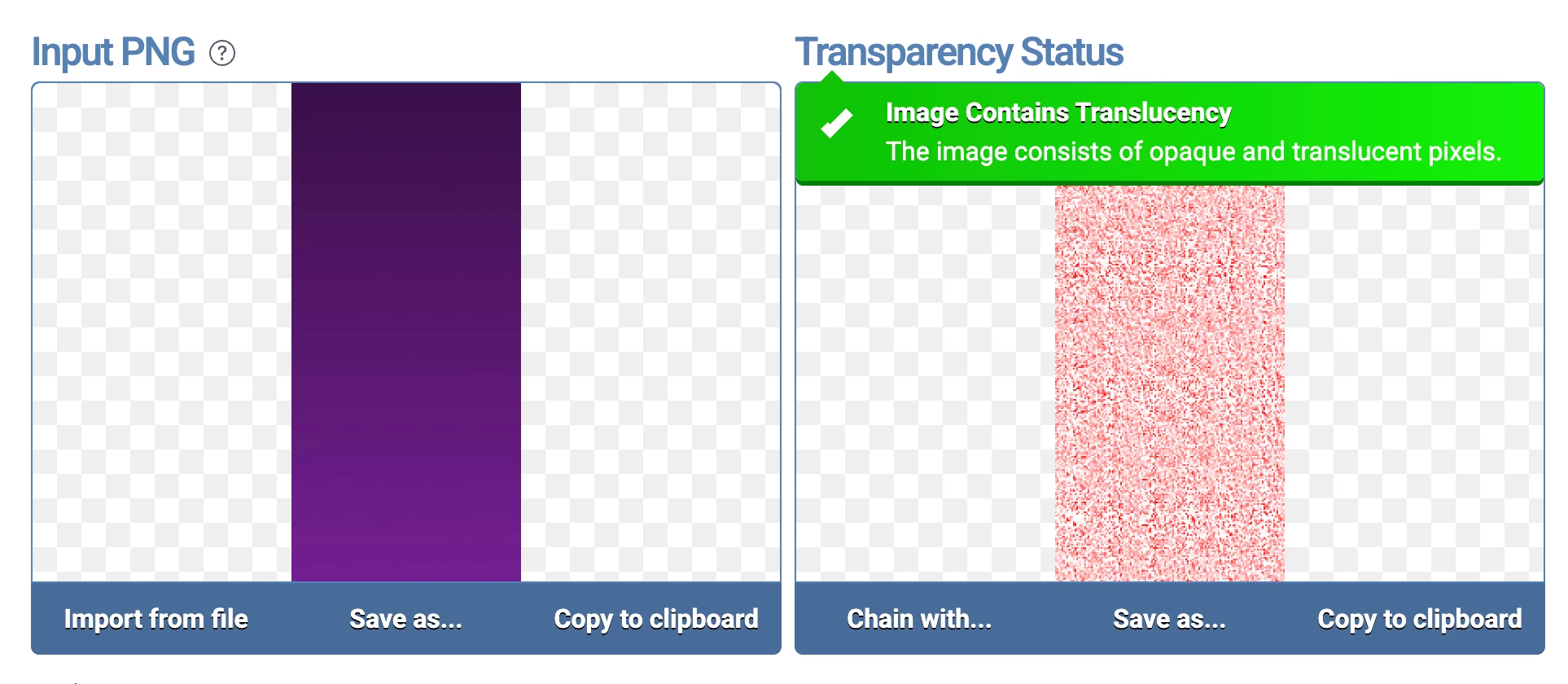

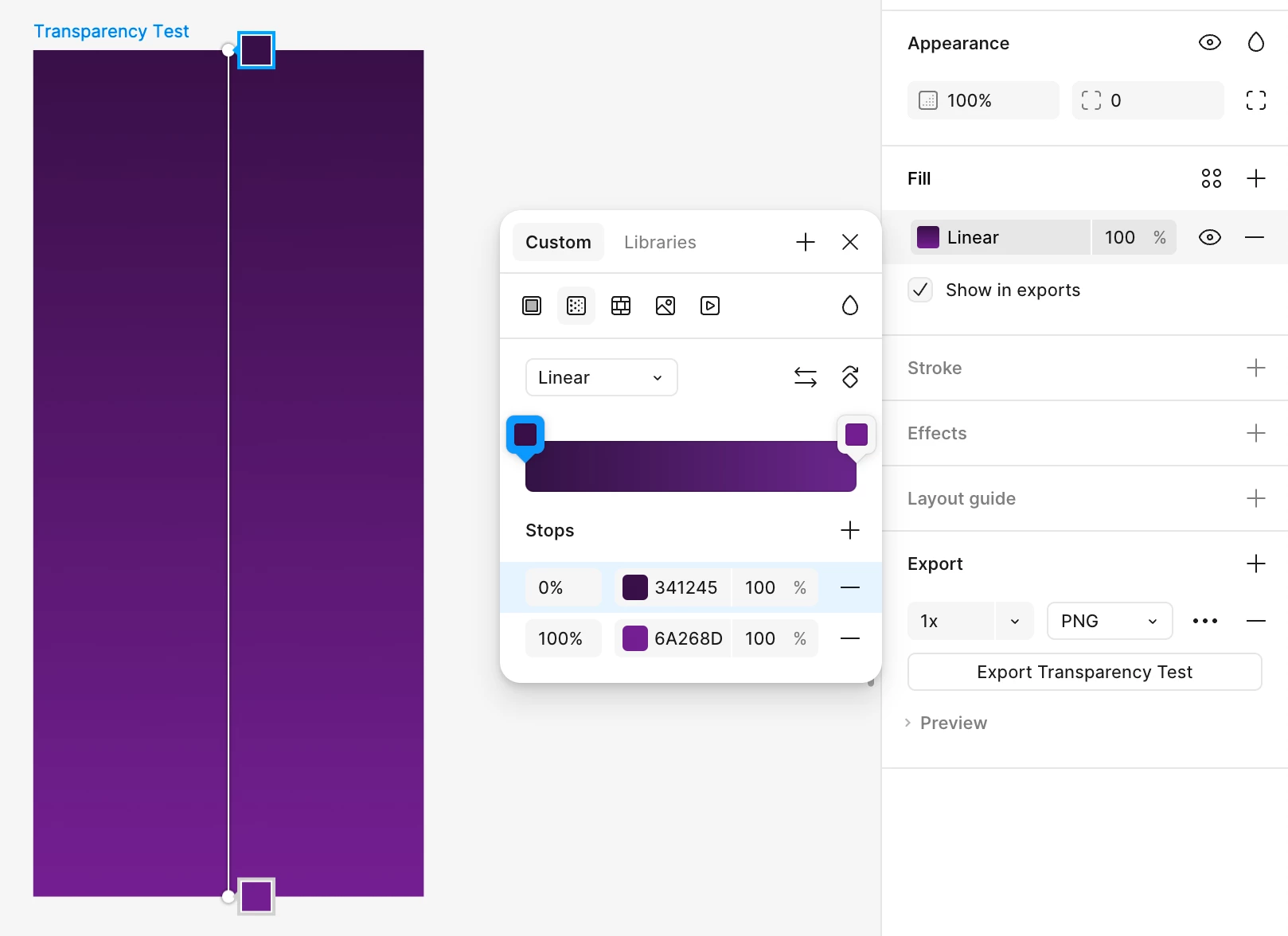

I just ran into this issue myself. I changed a frame’s background from a solid color to a linear gradient (two stops, both at 100% opacity), but the exported PNG contains unexpected transparent pixels.
Using an online transparency checker, it clearly shows the semi-transparent pixels.
This appears to be a bug. Adding a second solid fill layer to the frame does NOT fix it. The only workaround I’ve found is to set the frame’s fill to a solid color and apply the gradient on a separate layer—adding unnecessary complexity to the layer stack.
