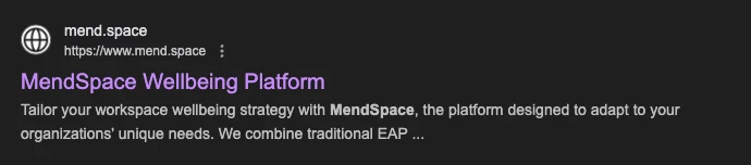

Two issues I’m facing, setting up robots.txt and favicon. It appears the defined favicon isn’t returned using the expected “domain/favicon.ico” path:
Which prevents it from properly displaying in search results:
Feel free to DM for further discussions on this.
Edit: First time having to deal with SEO so while writing the post thought there needs to be a way to specify an alternative path to favicon, and indeed there is, will try adding:
<link rel="icon" type="image/png" href="/_assets/v10/3306a24706f741f0d19cf0054959abb7a662dbca.png">
