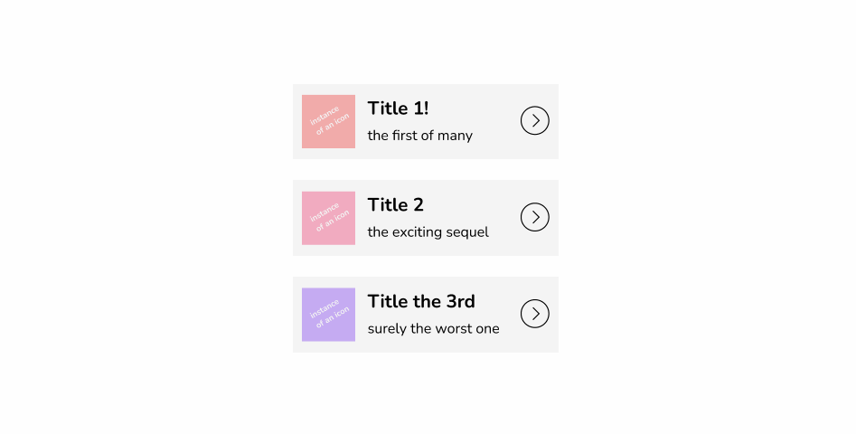

I have a list of cards. Each card is a variant with some properties of the same instance, say “title” and “description” to it.
I want click each of these instance to open an overlay that also changes depending on what i clicked.
in simple words, i want the popup to restate parts of the thing i clicked on.

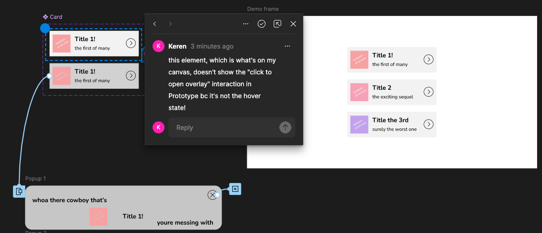

However, all these clickable instances are the Hover state of their element. I could manually make them each change some variable if they were on my canvas as that hover state, but they’re not, they’re default states, and only have that interaction of click to open overlay when they’re hovered.
This means I can’t even manually make each instance in my demo change variables to what it is before showing the overlay, as they’re not editable for me.
I looked around for other ways to get this effect with Component Properties but I can’t make those go into the variable!

I noticed the “Card” component set in your screenshot, which includes two variants. I’m assuming the lower variant in the set is intended for the hover state since it seems to have a hotspot for an overlay interaction.
I’m not entirely sure what your goal is, but are you looking to apply a string variable when the overlay is opened, with the variable reflecting the text property contents of each instance in its default state?
If that’s the case, you can set a variable when the overlay opens by adding a Set variable action as part of multiple actions.
However, unfortunately, at the moment there isn’t a native method to automatically generate a variable from the contents of an instance property or to assign a string variable directly to a text property of an instance.
