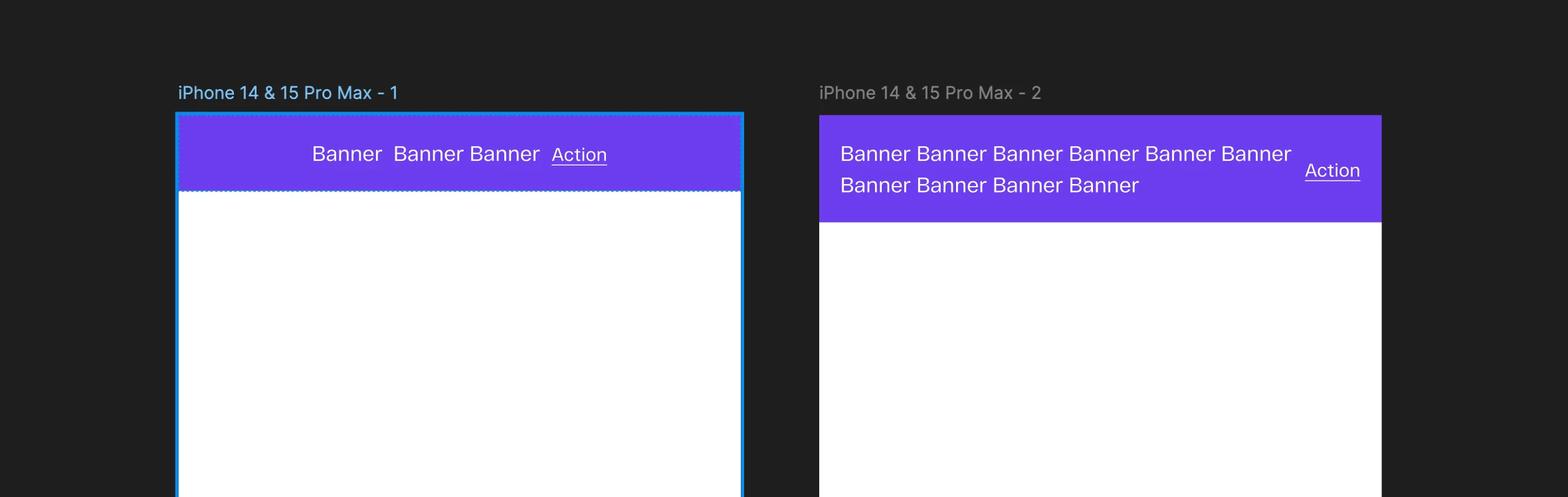

I'm building a responsive alert banner and trying to achieve a behavior similar to fit-content in CSS. Here's what I need:
  • The banner container stretches to 100% width,
  • Inside, there's a button and a text label,
  • The text should stay on one line and hug its content until it reaches the limit of the container,
  • Once it can't fit anymore, it should wrap onto multiple lines (essentially behave like fill).
Think of it as:
"hug content until there's no space left → then behave like fill".
This should happen dynamically, depending on the container width,
so no fixed max width.
Is there any way to simulate this behavior in Figma, maybe with some clever auto layout nesting or constraints?
Trying to avoid duplicating the component with two variants (hug and fill).
Thanks in advance for any ideas or workarounds!

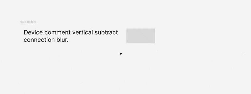

something like this?
Narelle
  • New Participant
  • January 27, 2026
Stevie3, that example only supports the wrapping, not the hug required when only one line of text
Narelle
  • New Participant
  • January 27, 2026
Francesco, it appears to be a current limitation of Figma, as the container can either be fill or hug only. You can use the max-width to force a wrap on a container that hugs until it reaches that max-width, however the max-width is a fixed value so it can not be set to follow the parent container size.
