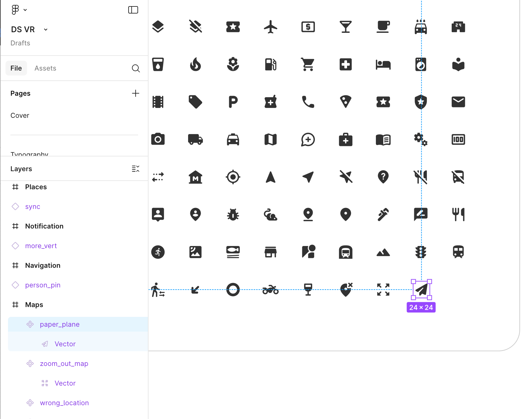

Hello,
I've added a new symbol (paper_plane) to my library but when I call it in a nested component, it doesn't automatically take the colors of my states (active / hover...). I read in another question that the layer must have the same name, which is my case. I've been looking for a while but I really can't figure out how to do it.
Any ideas? :)
Icon library : I added the paper plane, same name “Vector” in the componant

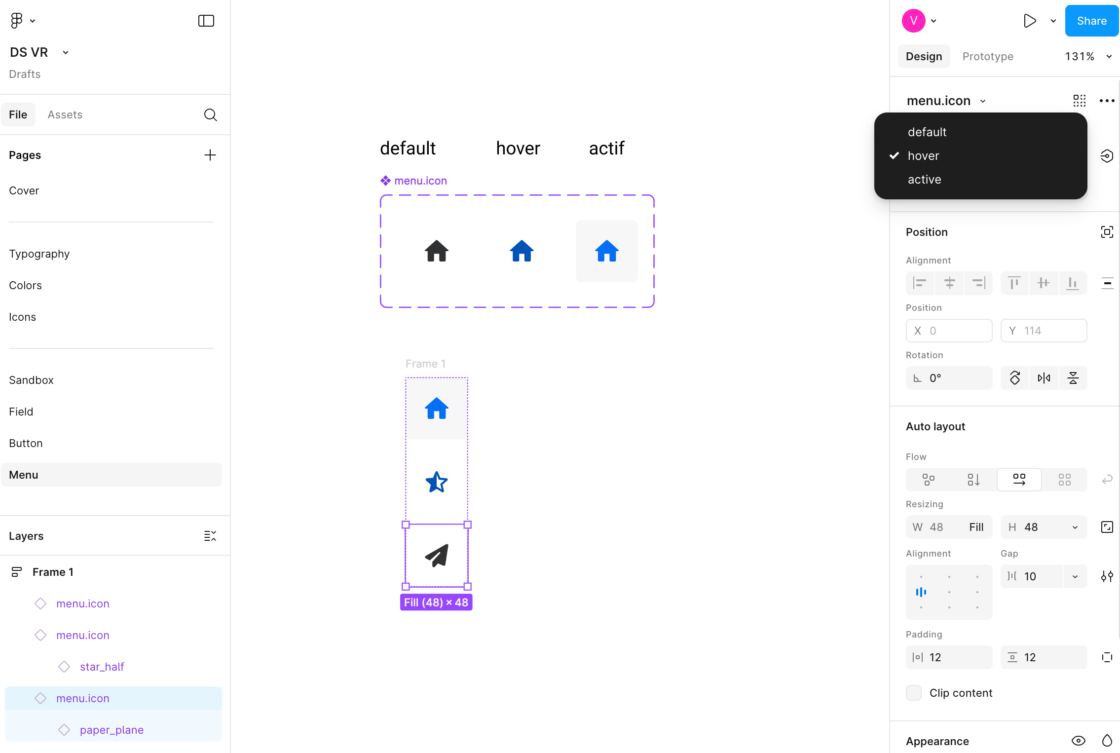

 But color don’t override when I change the states
giliard
Jun 11, 2025 4:01 PM UTC
That is probably because there are already changes in the instance that overwrite the original, I'd suggest reseting the instance before swapping the icon.
