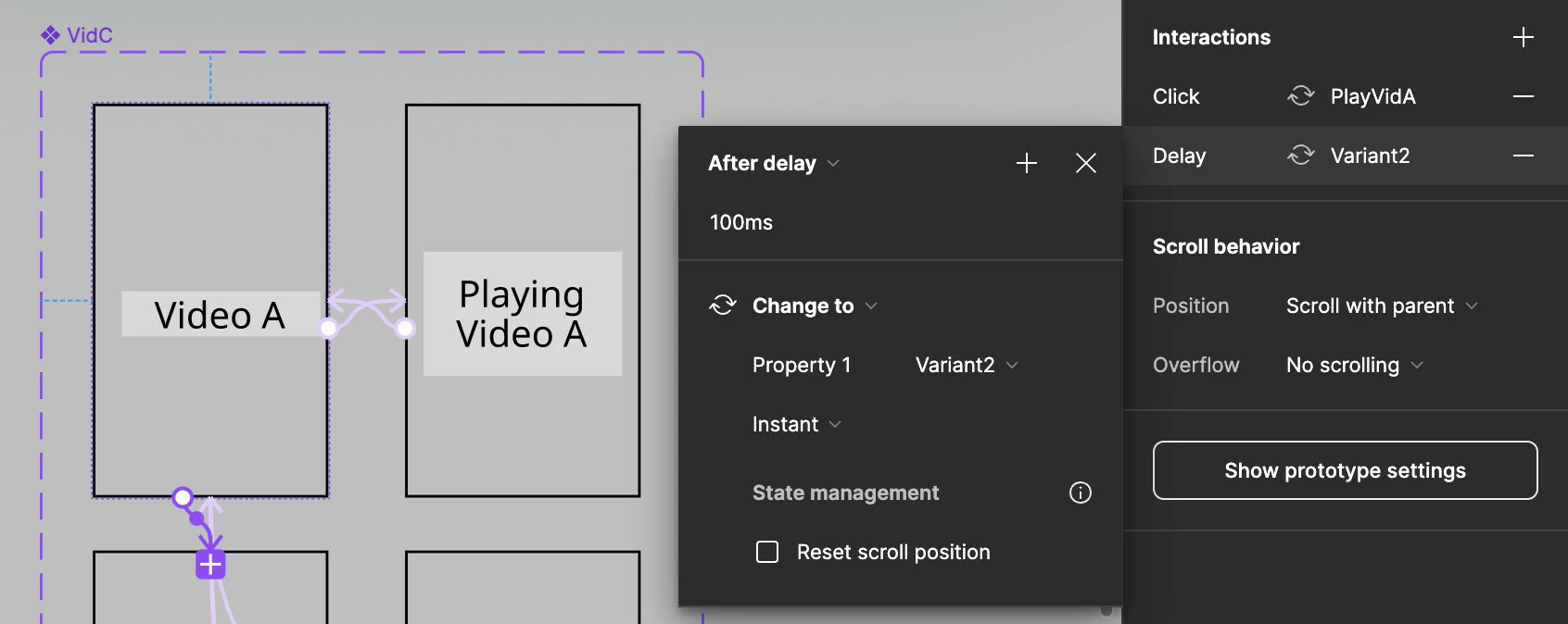

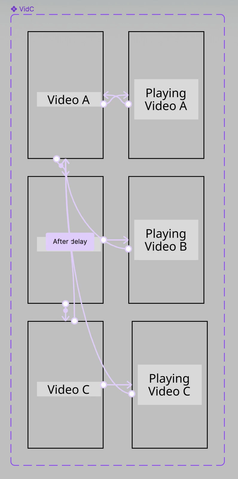

Create a Component with 3 Variants having the Video Images, and 3 More Variants having corresponding Videos.
Change Image variants using After Delay (100ms).
Assign On Click to each Image Variant to Change to corresponding Video Variant.
