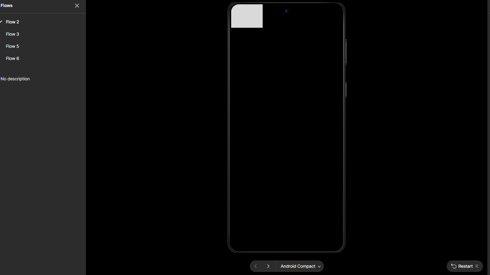

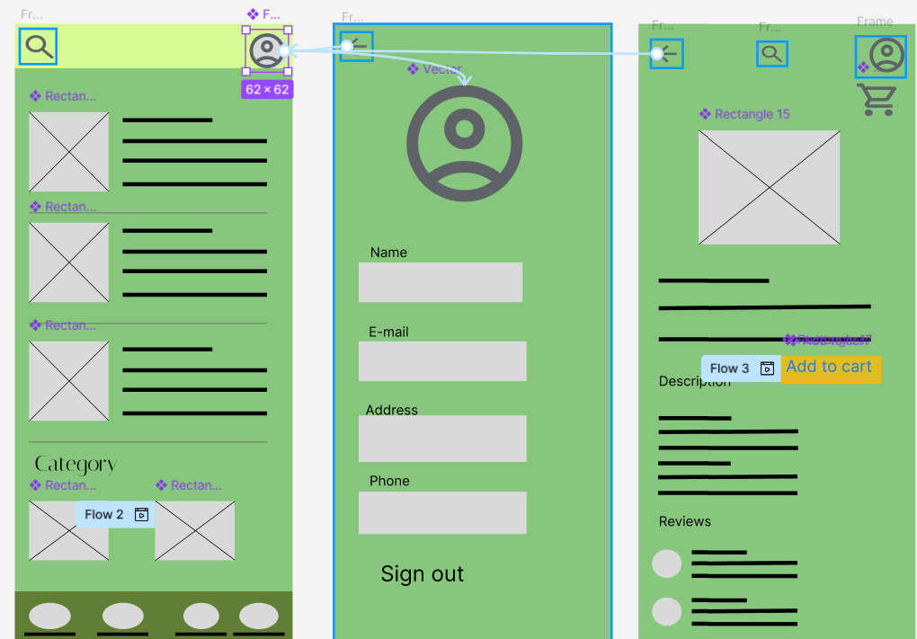

Hello, I have 2 questions:
first, if I need to create an interaction to a particular destination page, it won’t let me until I do create ‘create component’ for an object and choose it. Is there a way that I can make the destination is the whole page?
second, the prototype doesn’t show the whole screen for my design and doesn’t allow roaming between the  interactions I created freely . Am I doing something wrong?
I included what I mean in the 2 screenshots below. Thank you in advance.
Best answer by Raphael_M
It seems like a lot of them are outside of the frame, and your flow starts on everywhere. Try selecting all of the content for each frame then ctrl + alt + g (cmd + alt + g) then do it consequently to other frames. That would fix the broken prototype view, they’ll only work if they’re in the same main container (frame).
Then for scroll to just like what you did on the first interaction to profile icon on the other page. That’s not possible. You can only navigate to another page and not scroll to (unless they’re on the same page) you have to adjust the connection so it’ll point to the frame not the element.

@Raphael_M
I want to thank you so much. Your answer actually fixed the whole thing for me after being overwhelmed for a long time. Bless you and wish you the best💞
