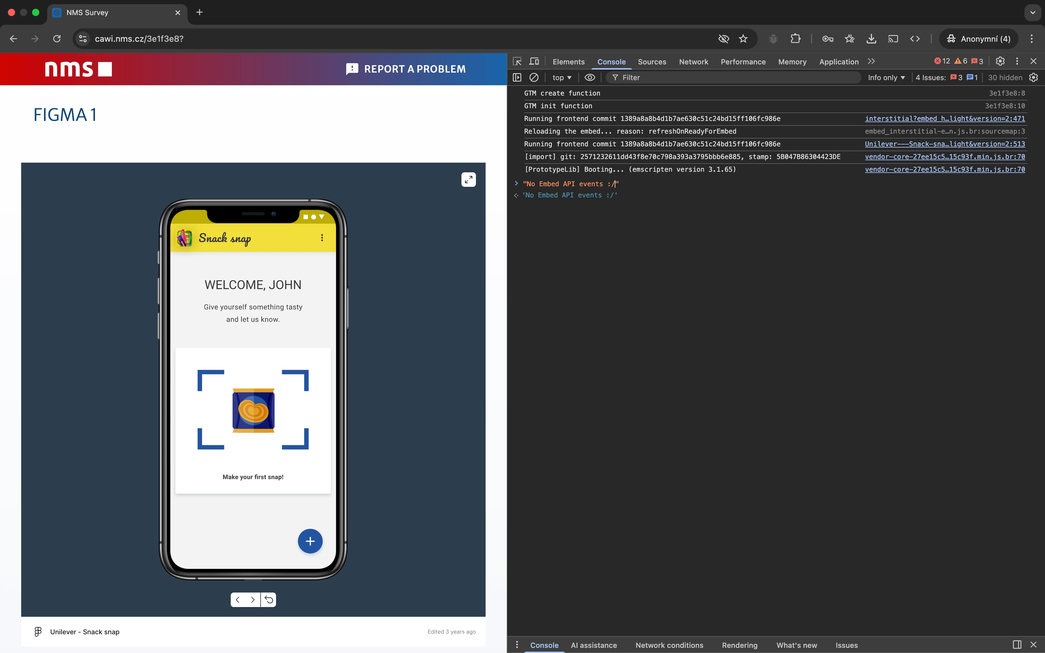

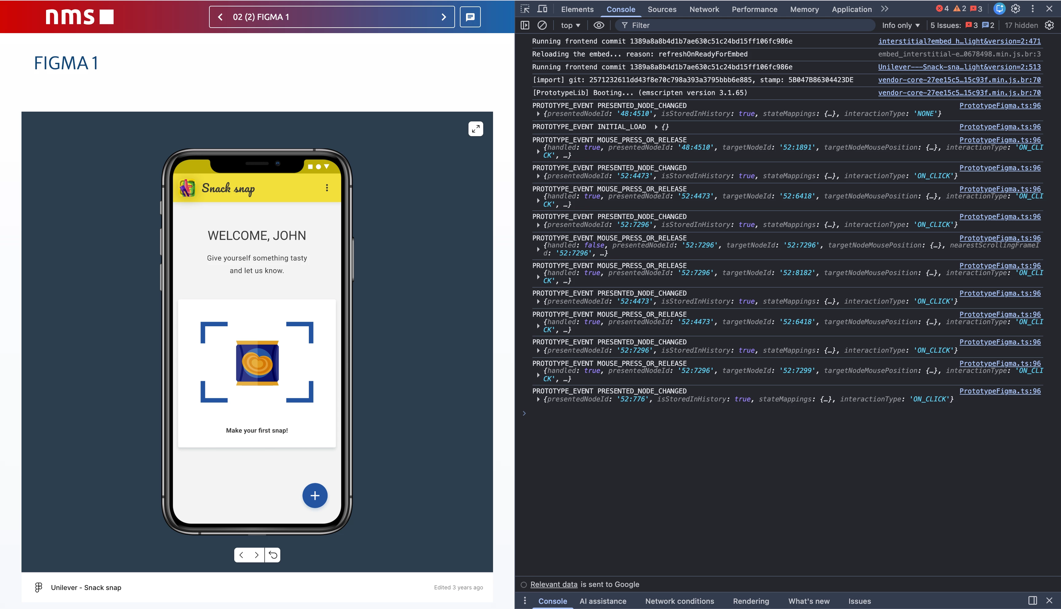

When I am logged in:
But in anonymous window (without logged into figma) there are no events.
Prototype is loaded, but Embed API does not work, unless I am logged in Figma.
