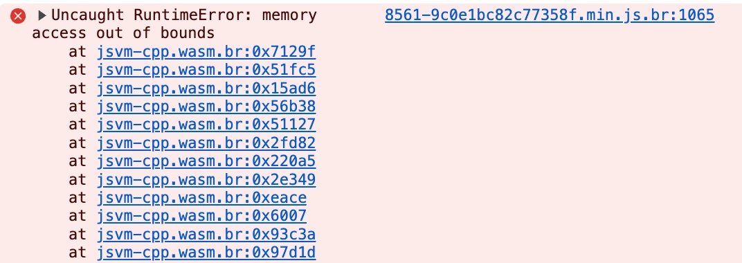

We’ve built a Figma plugin that converts frames into MJML/HTML using a WebAssembly module. On some machines the plugin works fine, but on others (mostly Macs with Apple Silicon) it crashes part-way through with this error:
What happens:
  • Some components (usually text) render successfully.
  • As soon as the plugin hits a problematic component, it throws the error and everything after that fails to generate.
  • The issue isn’t consistent — some users/accounts never see it, while others hit it frequently.

It looks like the WASM module is running out of memory or hitting a bug with certain text inputs. The error consistently comes from the WASM runtime.
Has anyone run into this before with plugins that use WASM?

Did we get this issue resolved! I am having the same issue and tried clearing cache as it was proposed by another forum.
Error:
vendor-core-22161ccd…fde64a.min.js.br:58 MobileFileViewer: failed to initialize RuntimeError: memory access out of bounds

For us, it was due to the way the project was built. A new typescript loader library was used to build the plugin for faster build process but it seems to have caused overhead for systems with lower memory. Now the loader library has been changed to a native one which seems to be working properly for devices with lower memory too.
