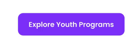

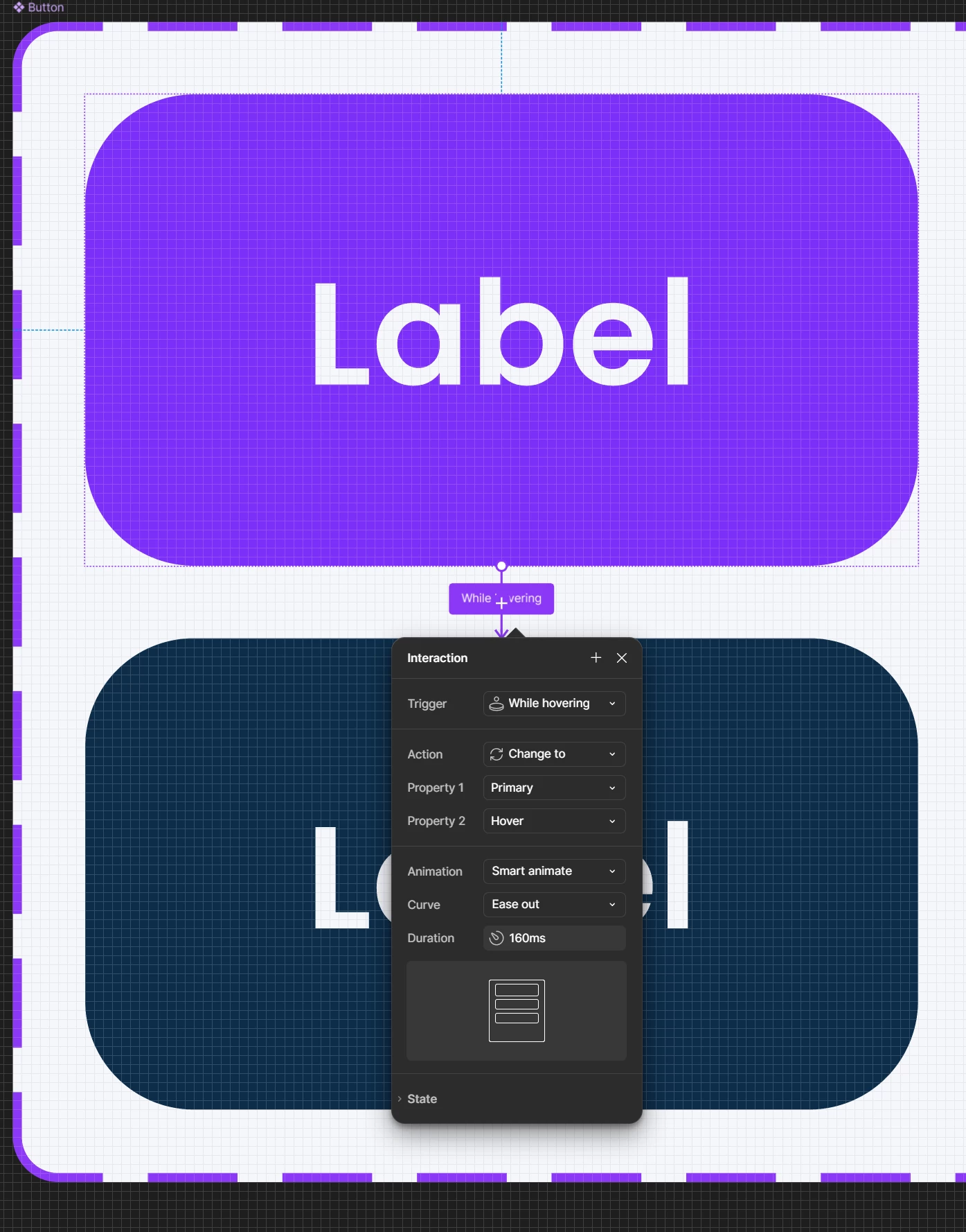

I have some buttons that have a hover effect and in the prototype there is slight movement of the content.
  • I checked the position of the content to be the same in both instances (default and hovered) in regards to the margins and in between items
  • I applied a “while hovering” interaction with instant animation
This also seems to happen in between separate screens of a prototype for text in a header component that doesn’t have animation applied or any other interaction.
Screen Recording 2022-10-19 at 14.12.55
Anyone has any idea?

the only fix I know is you need to add a border but just make it match the fill color if you want to make it look like borderless.
Rob20
  • September 5, 2024
Not sure whether you’re Grouping or Framing elements - but I found Framing instead of Grouping elements solved my problem.

Well, just to give some of context. I was creating a card component with hover effects on Figma. Then i use that component inside a frame with auto-layout, and when prototyping the whole frames moves with no sense.
The solution: I had to ungroup all the frame and the auto-layout where this component was. And now the prototype runs like it should.
So… it looks like when is inside of an auto-layout or frame always do not work properly the hover effects on prototyping. And of course that is a problem, because doesn’t let you to use it inside a main frame or auto-layout …. :/
