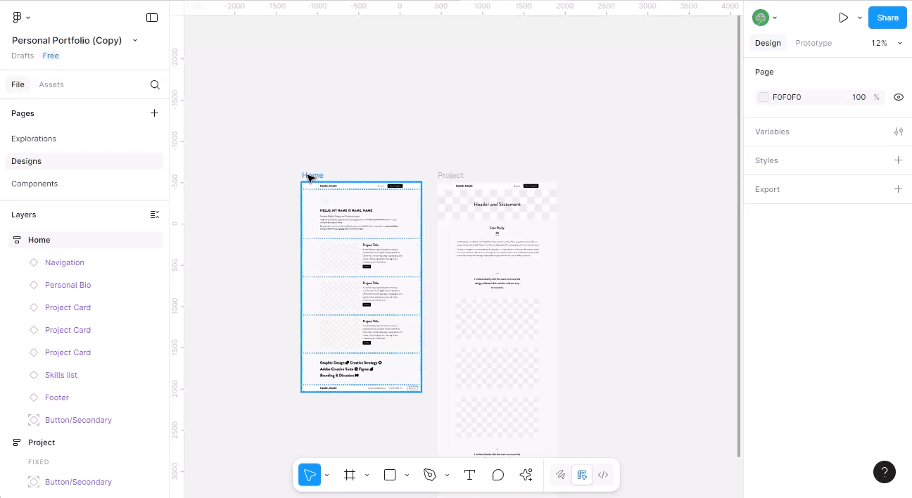

Hi. I checked your file and the canvas stacking was last on top instead a first on top. Just change it and the problem will be solved.
As an option, you can use a fixed instead of sticky, it will also work.

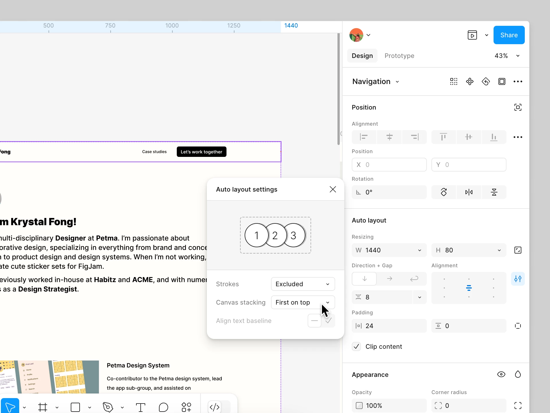

​@elleapopei ​@Nellya  Thank you elleapopei, Thank you Neyllya, I also had the same problem that the same one as elleapopei’s.
When I saw Nellya’s gif I kenw where was the point—— We should set the home frame’s canvas stacking to “First on top”, But I always set the navigation frame to “First on Top”. I think may be elleapopei also did it. Maybe the problem is the FD4B(2025) Chapter 31 confused us. In this option set step, I think the course should tell us which should be selected first, in my opinion I want the navigation on the top,so I selected it,but it not work.
I checked the passage and the vedio of this chapter, neither fo them mentioned which frame should be selected,in the vedio I can see the home frame is selected,OK, that’s right, I overlooked it. but in the passage the picture is that, It’s also selected nav frame.

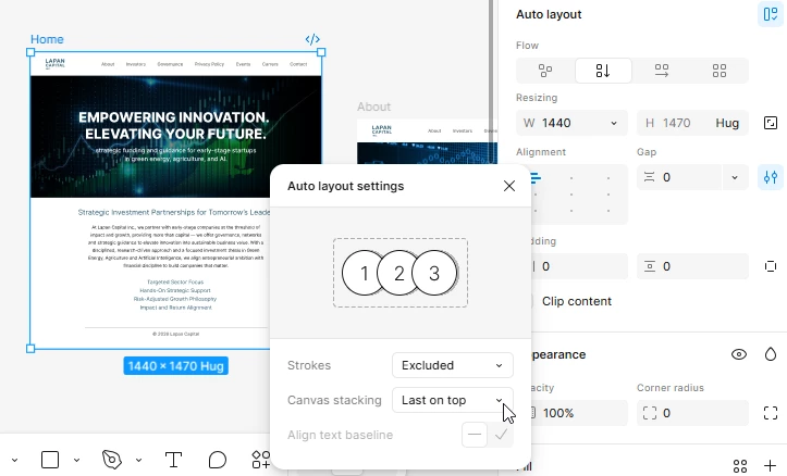

I checked the link and the problem is still the same: canvas stacking (Home, About, etc.) is Last on top instead of First on top
Lavina
Jan 5, 2026 4:42 PM UTC
Thanks so much Nellya. I misunderstood. I thought the navigation bar should be set to First on top. It’s actually the whole page (auto layout) should be set to First on top. Now it’s working. Really appreciate your help!

The course does little to specify that the CANVAS frame title “Home” is the one that should be set to “first on top.”
The confusion begins at the 2:21 mark in the video where it pans quickly to the auto layout settings and we miss (at least I did) that the main canvas titled “Home” is actually selected (indicated by the blue stroke that’s shown in the video). So in our minds, we instinctively assume the cursor selected the “Navigation” layer.

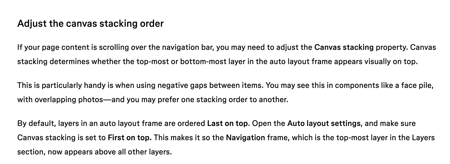

See attached image where the header reads “Adjust Canvas order...” pulled from the lesson. It’s there, yes, but something like “Select your canvas titled Home and go to your Auto layout settings...” would be great to include somewhere.
If the Figma team is reading these comments: If it’s possible to go back and update the voice over video — and update the language — to include steps in a numbered order so it’s crystal clear the CANVAS should be selected first, not the actual “navigation” layer, that would help clarify things even further for us beginners.
